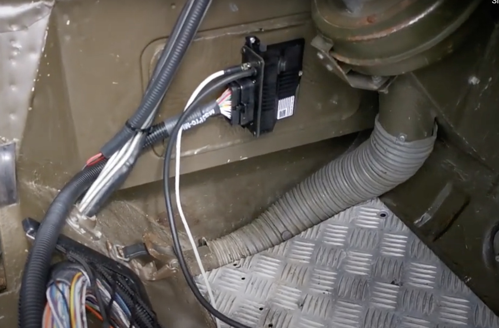

I installed it today and connected it to my laptop,
the only data i have for now is Manifold Air Pressure, as can be seen in below video,
I will install a trigger wheel on the crankshaft pulley, wideband O2 sensor and temp sensor.

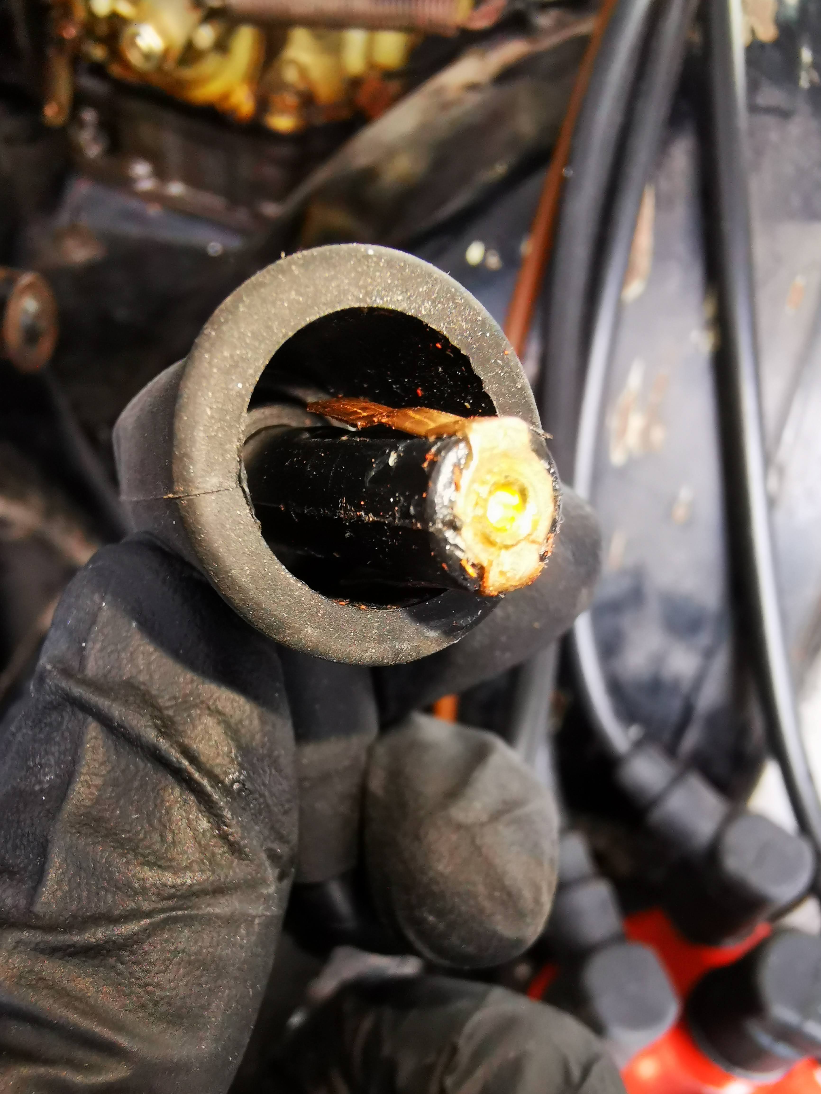

Little connector problem. I have the civil ignition spark plug cables, on the distributor side, it's a male connector, see 1st picture below.
But on my new coil there is a different connector. The rubber cap fits onto it, but inside it's not a female connector but a male connector.
Technically the tip of my current male connector would touch that male connector pin on the coil, but that does not sound like a good idea.
Anyone knows what kind of connector is this on the coil side ? I could buy or build an adapter, but not sure what to order.

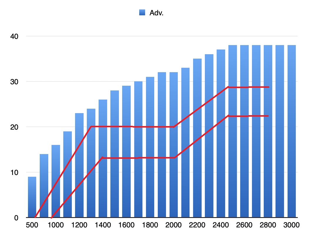

So my idle advance was stable so I decided to give it a try.
I first built the advance table based on the Pinzgauer manual, so purely based on rpm, not taking into account engine load, red corridor on bar chart below.
It ran ok but when starting to go uphill at mid rpm i had a bit of backfiring through the air intake, so probably firing too late.
So i then adapted my advance table to take into account load, but always stay with the Pinz manual red corridor.
Backfiring is now gone. Only impression is that power could be improved under load going uphill.
Should I push my advance beyond 28 degrees in these conditions (under load going uphill) ? 32 degrees maybe at first to see if it makes any difference ?
Running unleaded 95, at around 600m altiitude / ~2'000 ft
I show the advance chart shared by @rmel in this thread:
viewtopic.php?p=93655#p93655

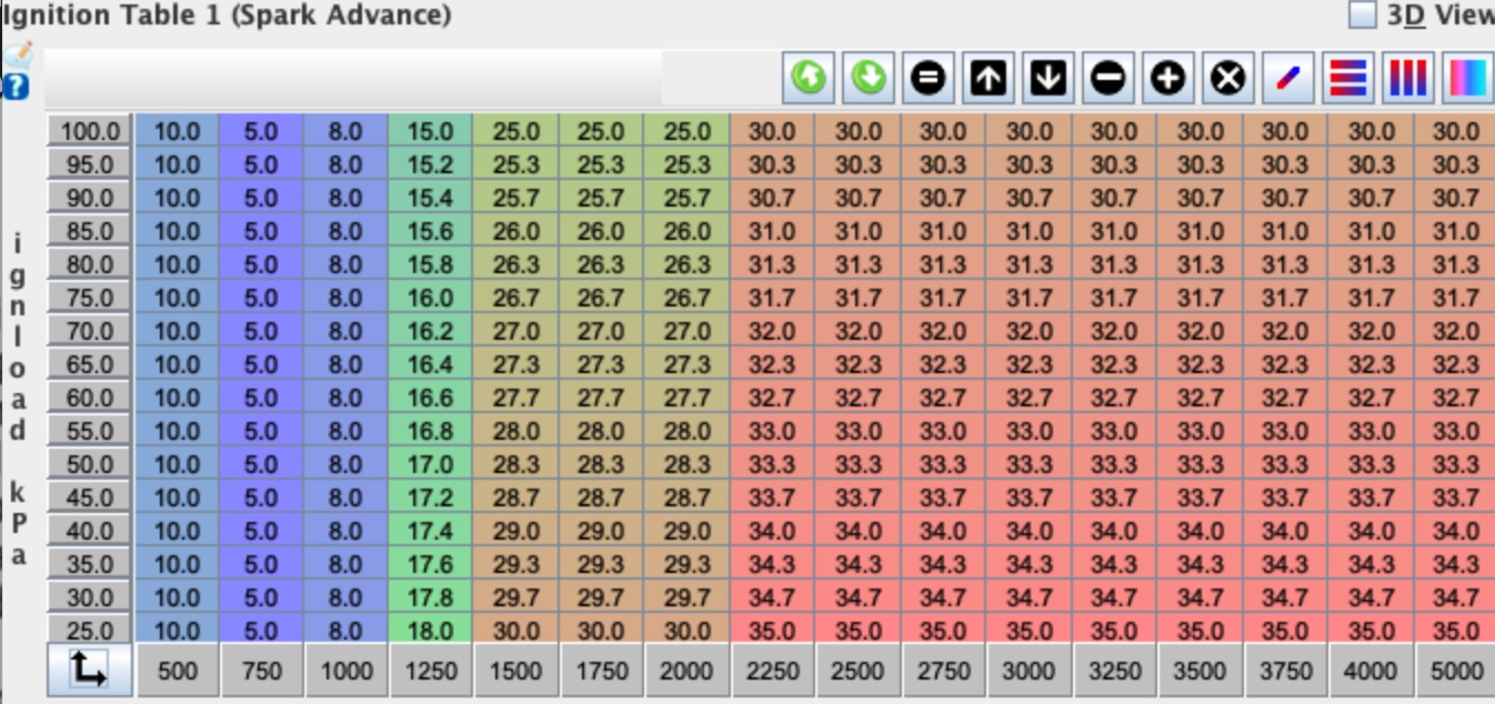

edit: after a bit of reading, i might have modified my advance table in the wrong way, looks like for a specific rpm, say 2000, as engine load increases (less vacuum), advance should decrease. My table below would be wrong then...
My current advance table: advance chart used by rmel , under load

Just to update this thread if ever someone goes the same way,
This is the ignition table i've been running with these past 2-3 weeks, looks good, could be tuned better, but good enough for now
