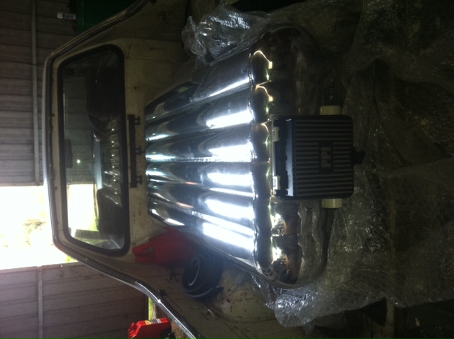

I was gonna post a pic of the tank I used, but since the forum updated to this new format it won't load photos for me, they stop loading once the "green bar" gets to 3/4 loaded?
Its a really unique solution that tripled my lpg volume for little extra weight. You can check them out though, it's made by PPI they're semi custom tanks made from aluminium you choose your width and length.
Mines 140lts and fits neatly in the rear "footwell"of my 712K making the rear bed area level with the wheel arches across the centre. This let me keep my 140lt petrol tank for extended range. Note my 712K is a civilian model and was ordered as a 4 door instead of 5, it doesn't have a rear door on the RHS and therefore has room for the larger petrol tank.

Lightweight internally baffled PPI LPG Tank...bit flashy ay.
Got a bit Photo happy as I figured out my pic posting issue.....cleared cookies all good, I always forget about that. 😳
