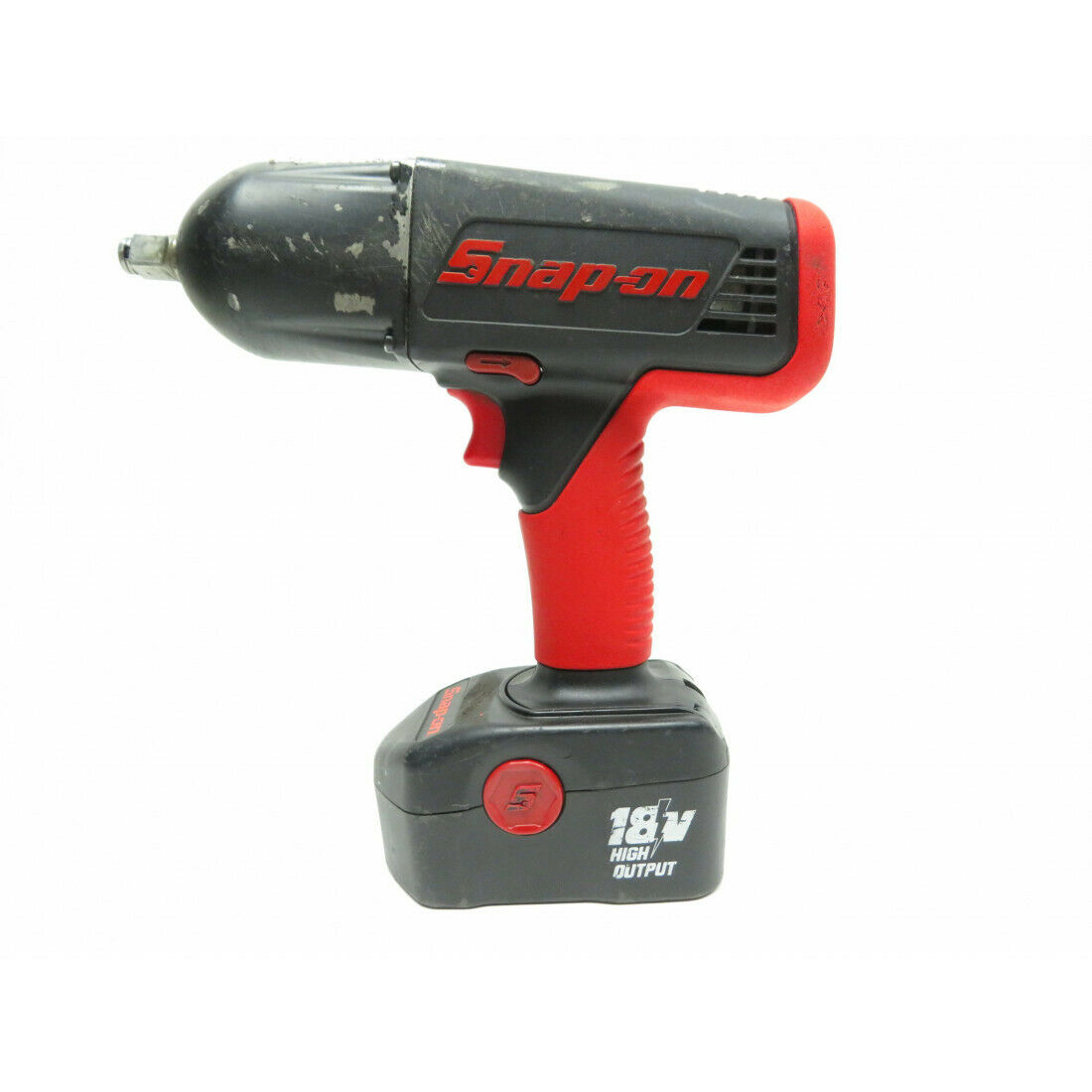

I'm not saying this lightly: This is the best and most surprising tool I have ever invested in!
I always carry it with me when going on off-road/road trips. It makes changing a tire, for example, actually enjoyable. People throw the term "game changer" around recklessly these days for new products but I think it applies here!
I bought it used for less than other brands new price.
