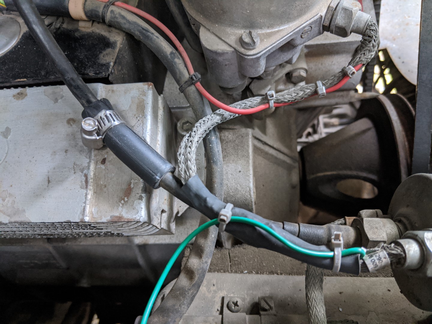

I observed that the coil wire rubs on the oil cooler, and added a protective rubber covering as pictured.
You can't see it in the photo, but the clamp is positioned such that it doesn't contact the oil cooler.
