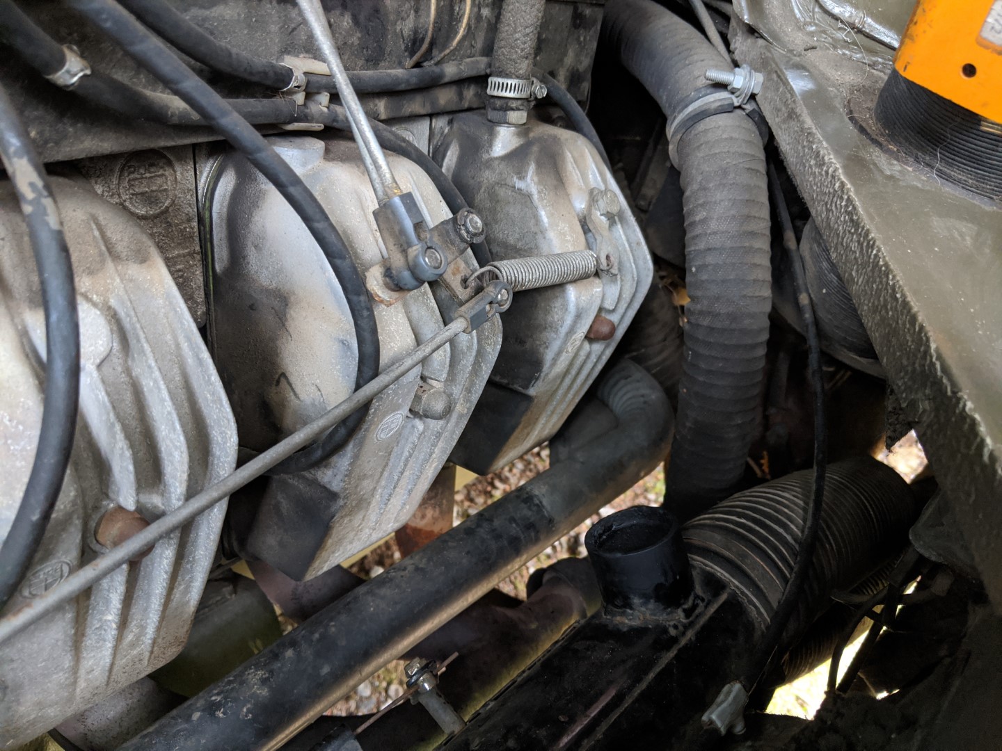

My 710K doesn't have this hose, and the port on the heater box (bottom of image) appears to be blocked off. Did some vehicles not get this hose or is mine missing something it should have?

Most likely the PO removed it due to a rotten hose.
I removed mine on the 712 for the same reason AND
it's just not needed in the moderate climate we are in.
I also removed the airflow valve at the throat of the
carb intake.
