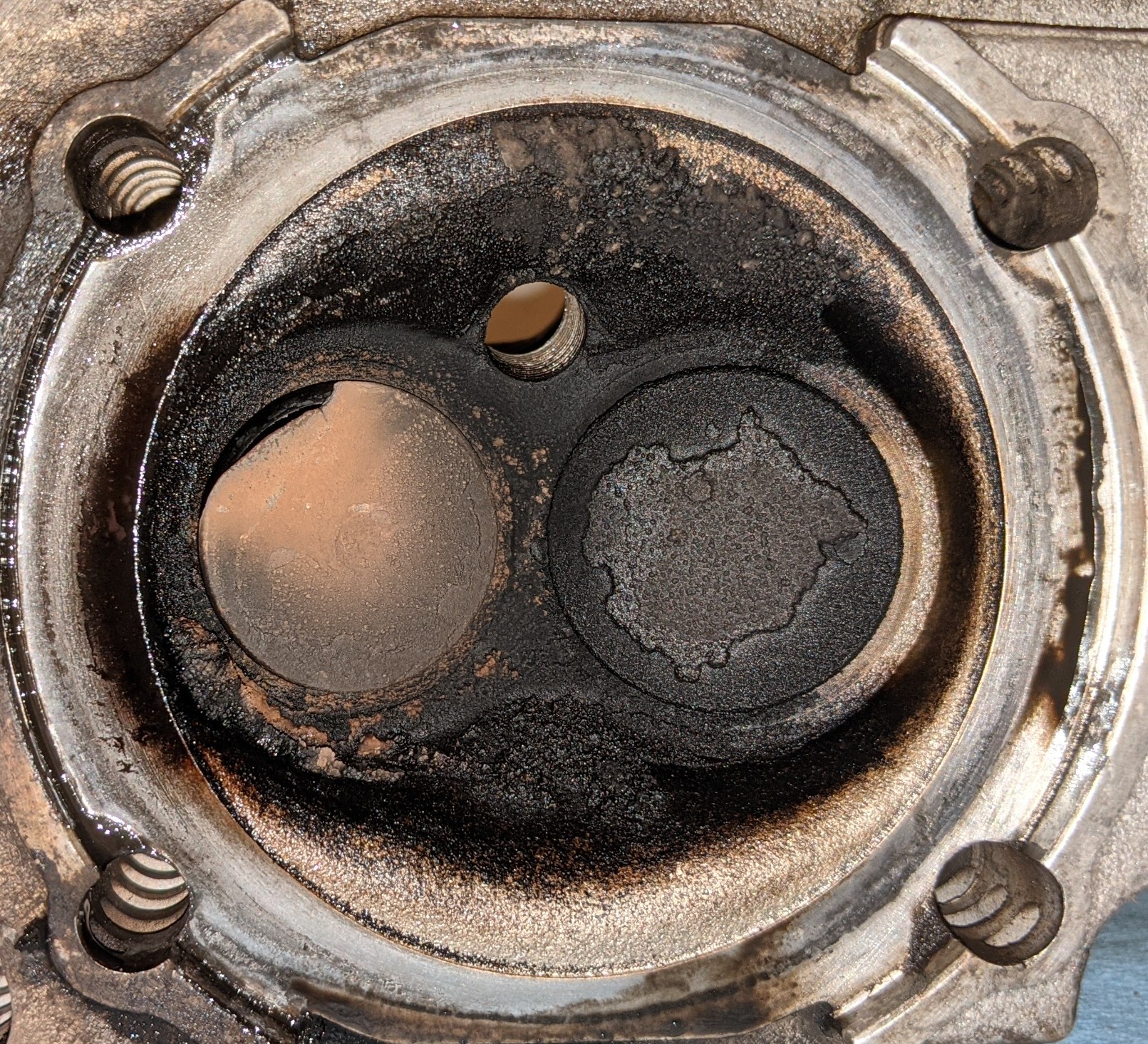

After the first post I found that the front carb had loose bolts on the throttle body. The rear intake manifold was loose on cylinder four, missing a nut but still snug. Also there were no gaskets between the intake manifolds and the heads. Those issues were rectified, but perhaps it was too late.
I removed the fourth head and found the exhaust valve to have a piece missing on the edge. Is this what they call a burnt valve? No pieces were found in the cylinder.
Currently I am trying to determine the cause of this. Could it be the lean condition from an intake leak that would cause the burnt valve?

Can you post a picture of that valve. A pix is worth 1000 words :DD

Posted: Fri Jan 08, 2021 10:10 am
by Pinzengauer

Burnt and appears recessed. Probably was running lean.
It would be wise to assume more than #4 is in need
of a rebuild. Or...you could roll the dice on #4 and hope for
the best -- what was the static compression on 1,2 and 3?

Static compression on cylinders 1-3 are all even at 100 psi. Which is not great. I want to do a full top end rebuild, but it's just not gonna work out right now.
As stated above, I had found an intake leak which made it run lean.
My current plan is to get number four back up and running and later this year do a major overhaul on the engine. I've been reading up on the 2.7 kit, seems to get mixed reviews for running at altitude.
Honestly I think the power increase and drivability would be drastically improved just getting top end back within service spec.

Well at 100 psi you have good cause to to do a top end job.
You are indeed in a pretty good center of gravity of Pinzy
owners and expertise e.g. Linden Engineering. Someone
might jump in and perhaps recommend a shop for Head
rebuild and jug boring if needed. You really want someone
with Pinz experience doing that shop work.
The #4 piston will have a size stamping on it that will give
the info you need to know the next click up in size if it warrants
re-boring. Check to see how in "Round" that jug is and of course
the wall condition. Y'd be lucky to get away with just a ring and
head job.
