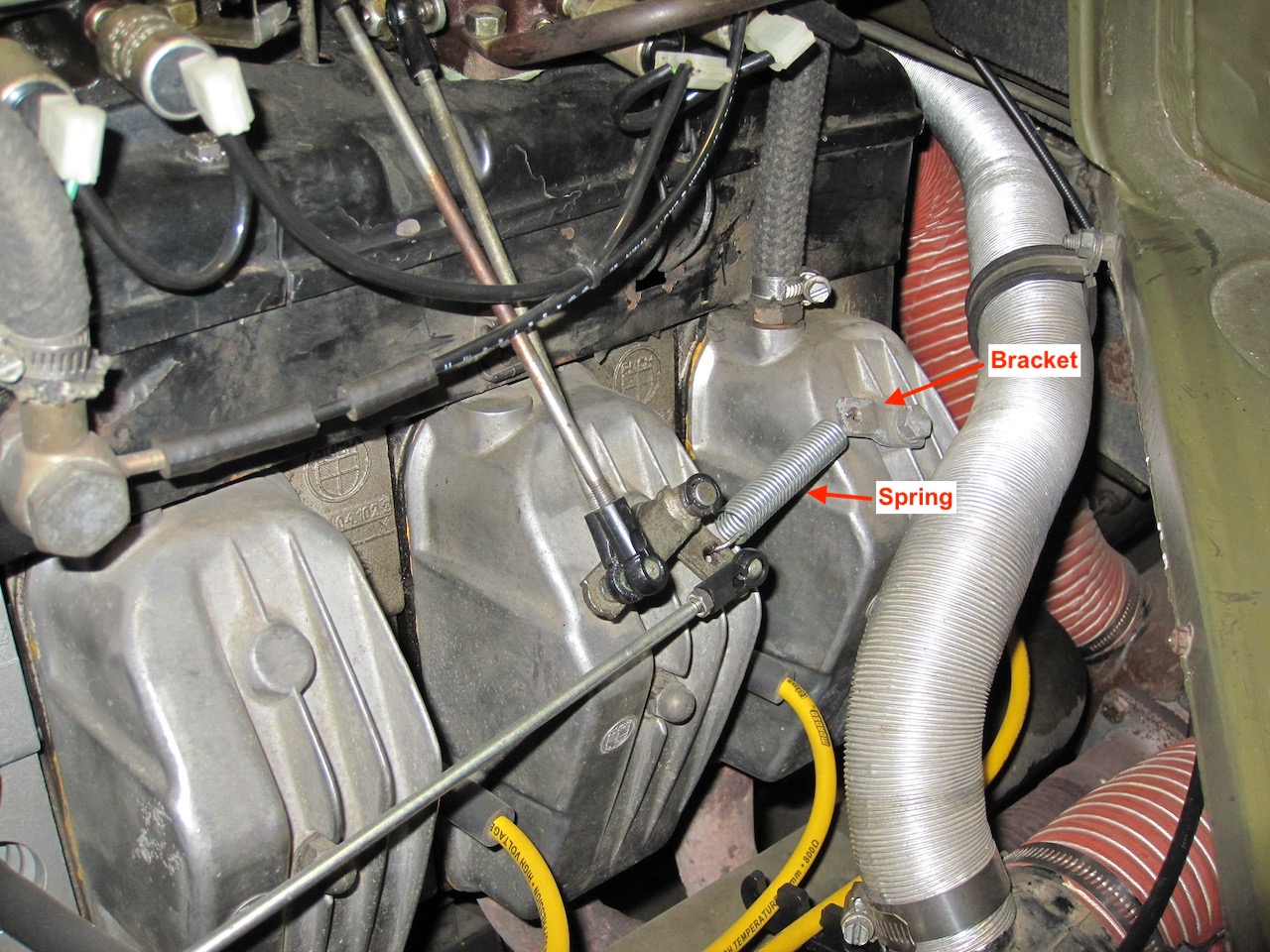

Here's a photo showing the spring that keeps the linkage tight and the accelerator pedal up. The bracket can be rotated after loosening the bolt to adjust the spring tension.

Pcolette - Thanks for the pic.
