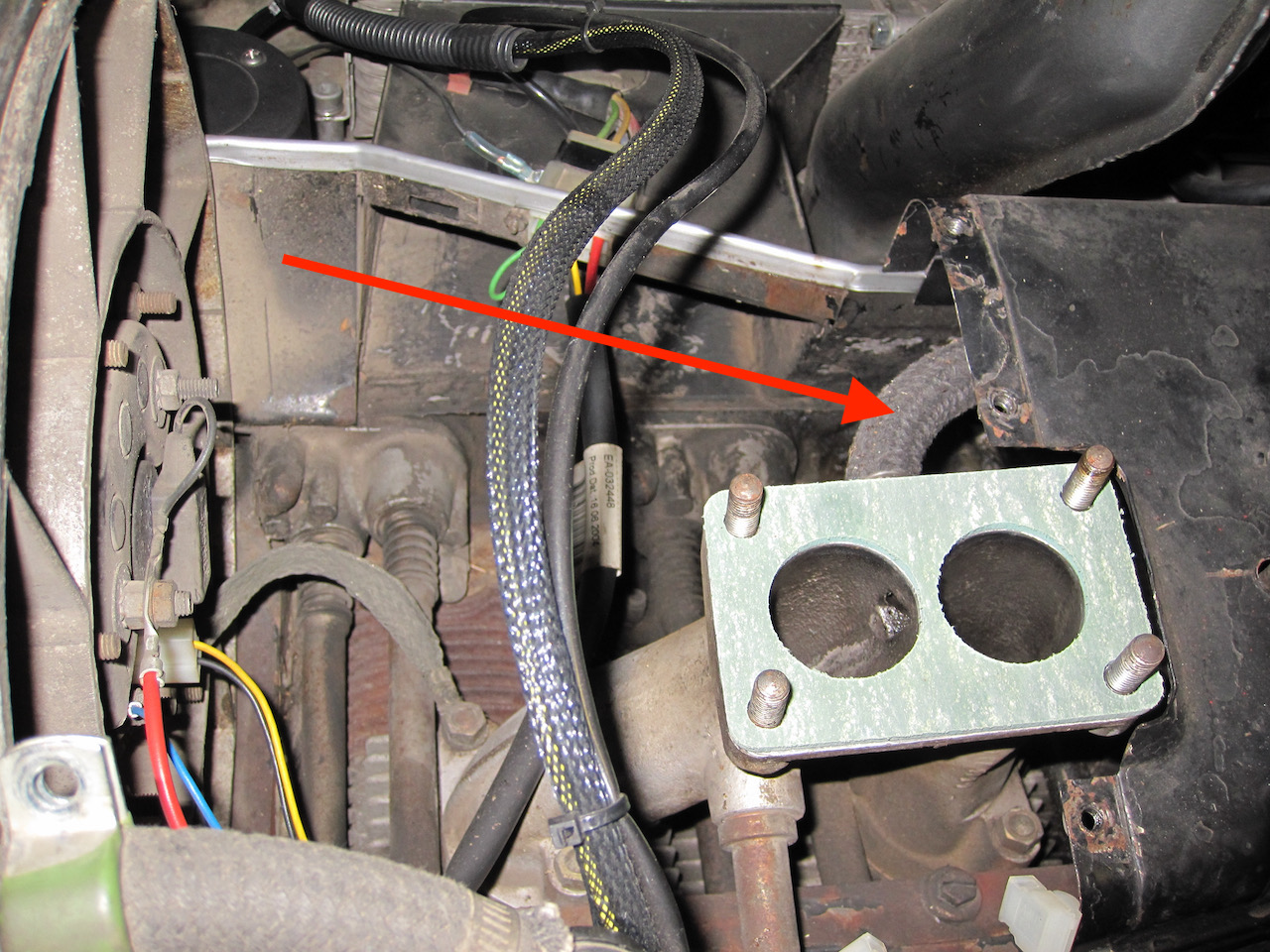

Possibly also check the intake manifold balancing hose under the engine tin. Group 1-35, item 60 in the parts book. It maintains equal air balance between the front carb manifold and the rear carb manifold. The hose is exposed to heat from the cylinder heads and begins to degrade over time.

The problem kept getting worse. I replaced all the vacuum lines, including he intake manifold balancing hose (thanks rmel & pcolette), installed a PinzSSI, and had the carbs rebuilt (thanks Goatwerks!). I just finished installing the carbs, and it now runs like a top! Starts easily, has a stable idle and very smooth acceleration. It's a good day. :D
