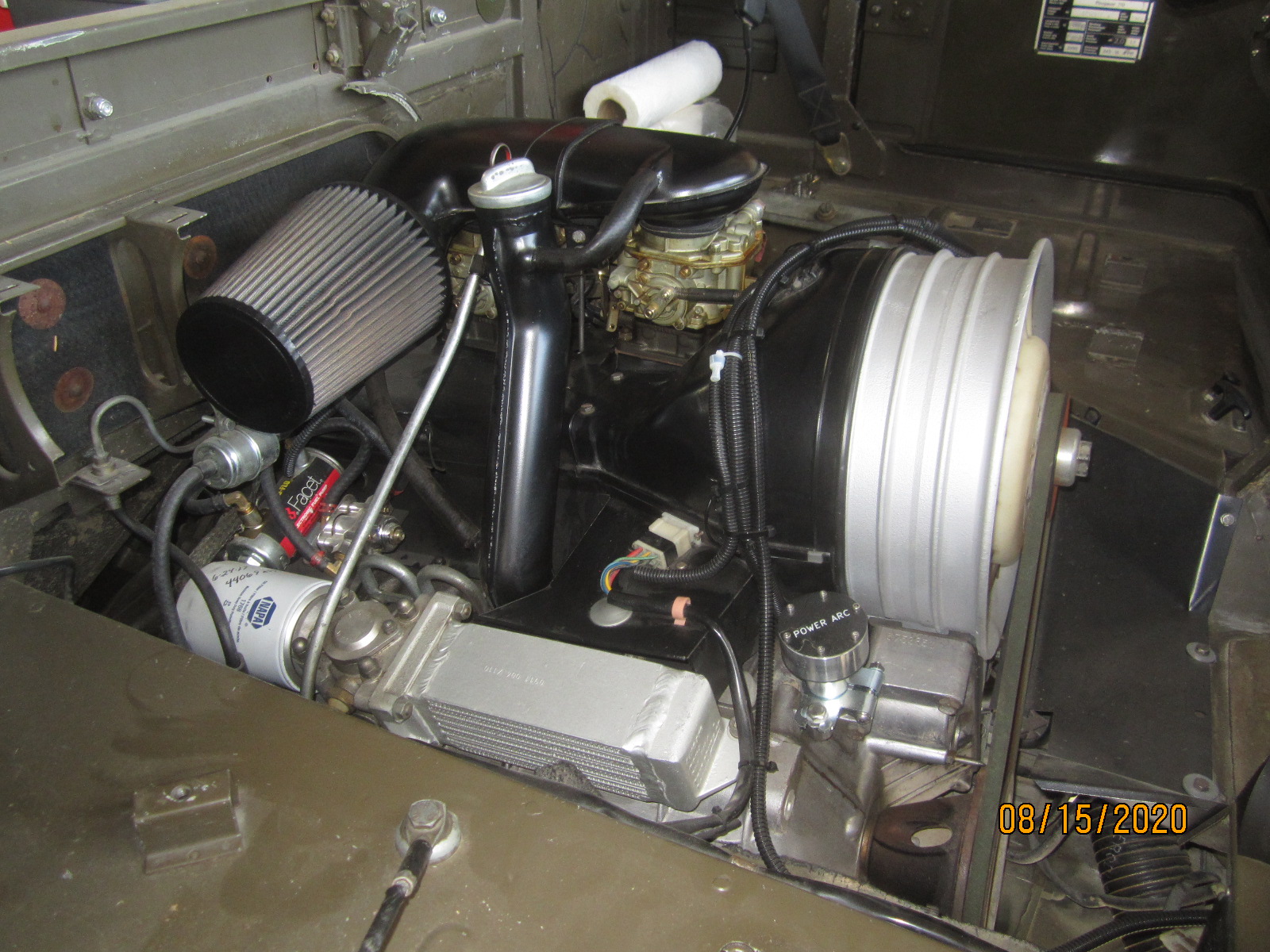

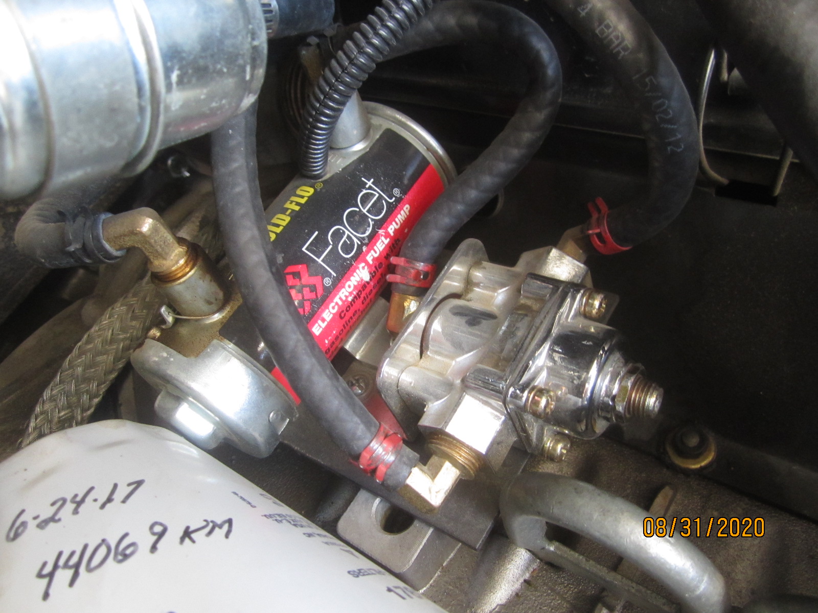

I have used a Facet electric fuel pump for about 7 years on my 710M. Never had a problem of any kind, and I have driven it at temperatures of 115 degrees. The engine starts easier when cold because the pump fills the carb bowls before cranking. I have the pump mounted on the engine right where the old mechanical one was, but an option is to mount it on the body or frame so it isn't subjected to vibration. I would never go back to a mechanical pump except in an emergency.
The Facet part number is 480564. The 24 volt feed is connected to the fuel solenoid harness. I have a Holley pressure regulator installed between the pump and carbs, but I don't think it is necessary as I had to adjust it all the way out to get the correct pressure. I left the regulator in place because it has 2 outlets, which allows an individual fuel line to each carb.
The PinzSSI 3.0 version is shown also.

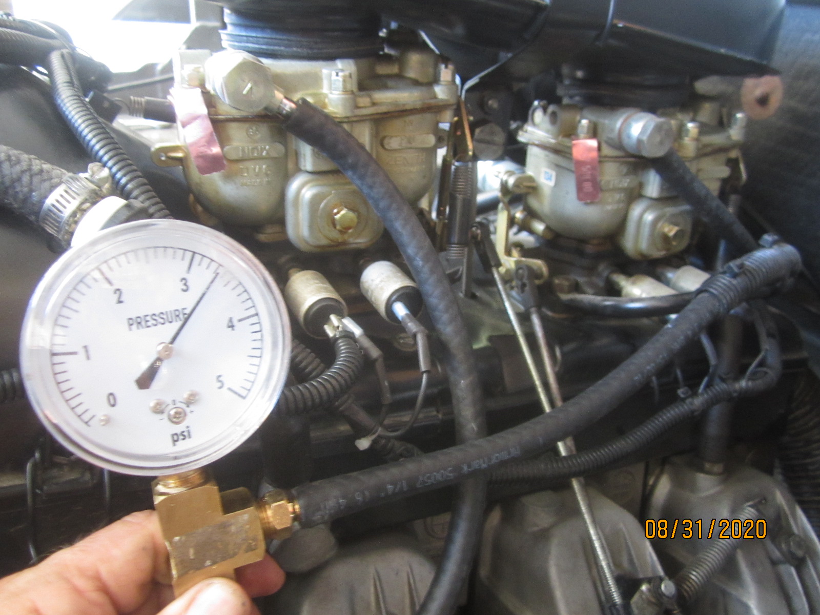

Post by pinzinator »
I did some verification tests on the fuel system today and discovered that the recommended pump puts out about 4.3 PSI unregulated. I dialed it back to 3.3 PSI, which took all of 2 minutes using a 16mm box end wrench and a 5.5 Allen. Here are photos-
