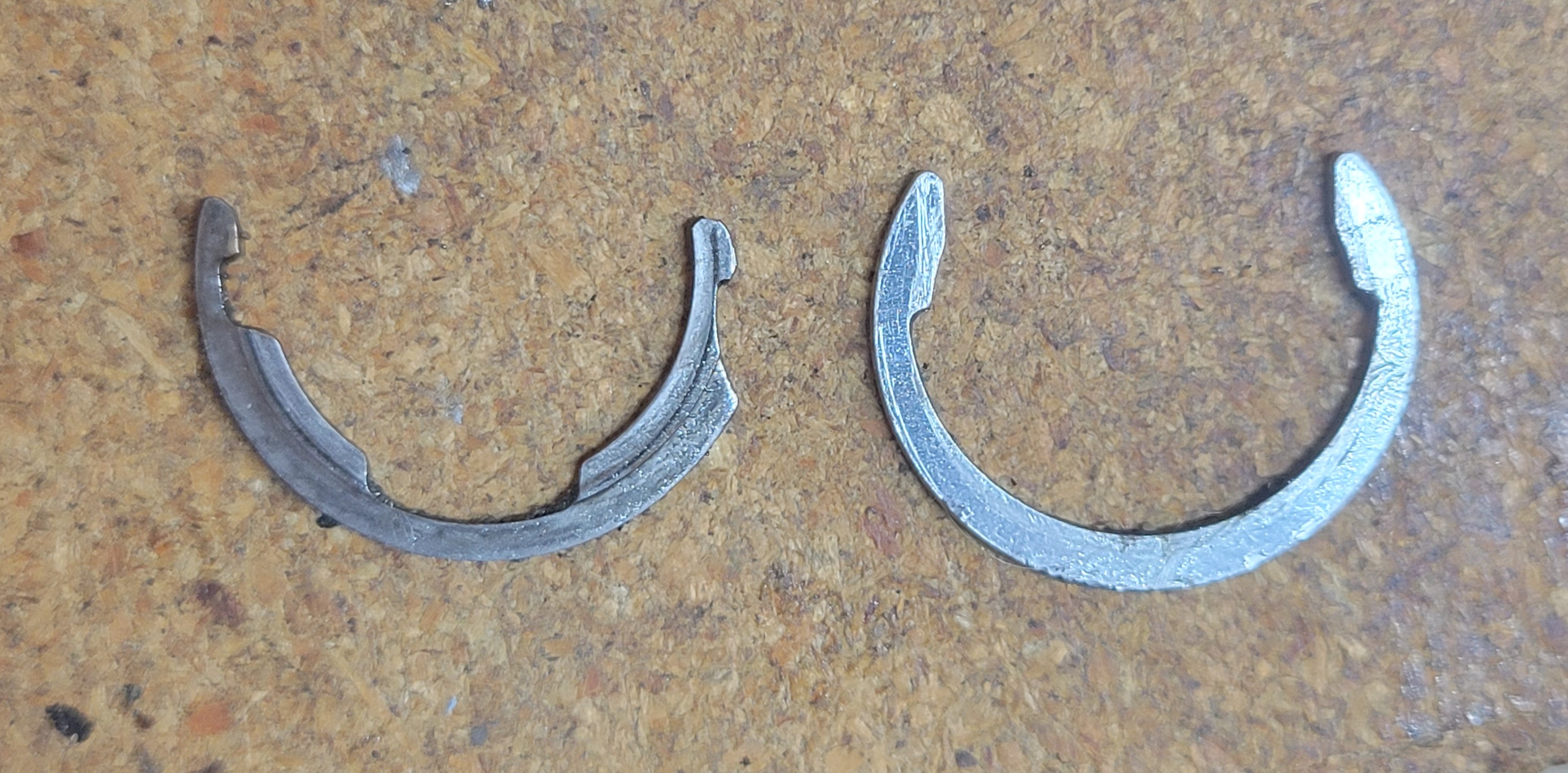

So, the retaining ring on the left is the original and the one on the right is the SAV part included with the shifter kit. The new one doesn't seem to hold the spring consistently, it will come flying back over it if you wiggle it around. Anyone else have this issue? I'm assuming the spring is supposed to stay under this retainer.

The original retaining rings are a 2-piece item that interlock with each other to create a complete ring. I have searched but they seem to be no longer available. The clips provided with the "kit" really do not hold well. I've rebuilt 2-3 of these and found some better clips that would stay on. I'll take a look through my spare parts and see if I have some or at least a part number.

Oh wow, that explains it. One of the pieces went flying into garage land. Never even considered that it was two pieces, thank you! I'll start poking around for a bigger fitting or something. Deconstructing the shifter and linkage is like wrestling an alligator covered in grease......been a challenge even without this flying ring..... 8)

Hey Paul, I think I found a replacement at Expedition Imports. Thanks for helping me out. If you do come across the product you used I'd appreciate that information as these clips are pretty tough to find.

I dug through my old parts but can only find the clips that came with the S-Tec kit sold by SAV - the ones that won't stay on.
I think I bought some clips that worked from McMaster similar to these: https://www.mcmaster.com/products/retai ... ing-rings/
