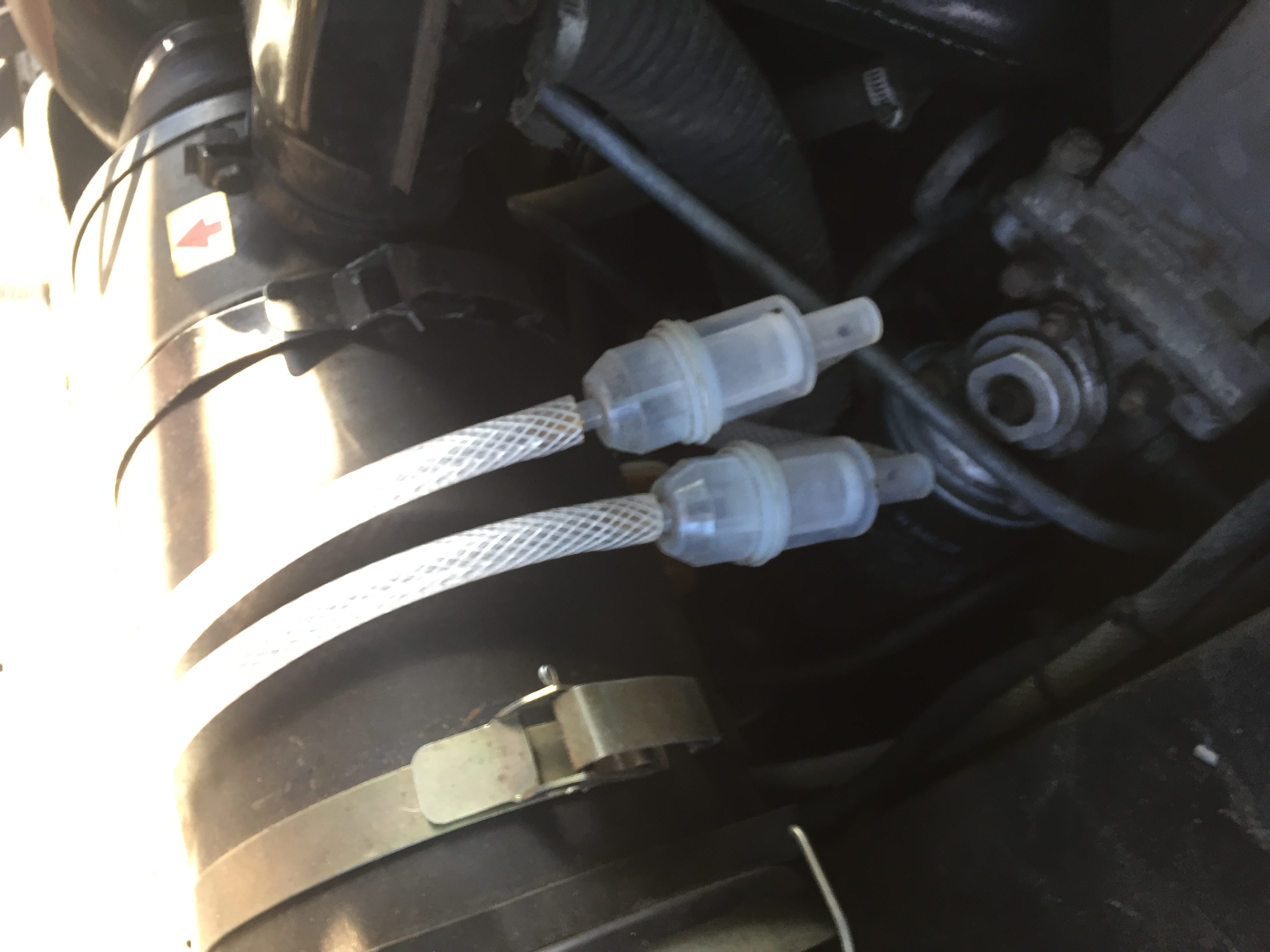

On a related note, Steyr routes the axle/trans breather hoses on the Gwagens together, up to just in front of the brake booster area.
It's common to put the smallest fuel filter you can find on the breather hoses to keep dirt/water from being sucked in (in theory that could happen)

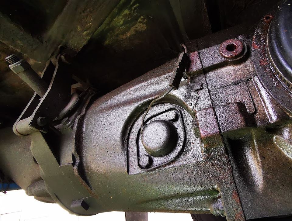

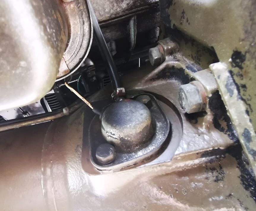

Just reopening this thread as I have a related question,
On my 710M i do have a breather tube on my front diff, first picture below, going into the engine compartment and ending with an air filter.
But what about the rear diff ? Second picture, I don't see a breather tube, and if not, why is it needed on the front but not the rear ?
thanks

Re: installing differential breathers
Posted: Fri Oct 04, 2024 3:46 pm
by Stumbler
