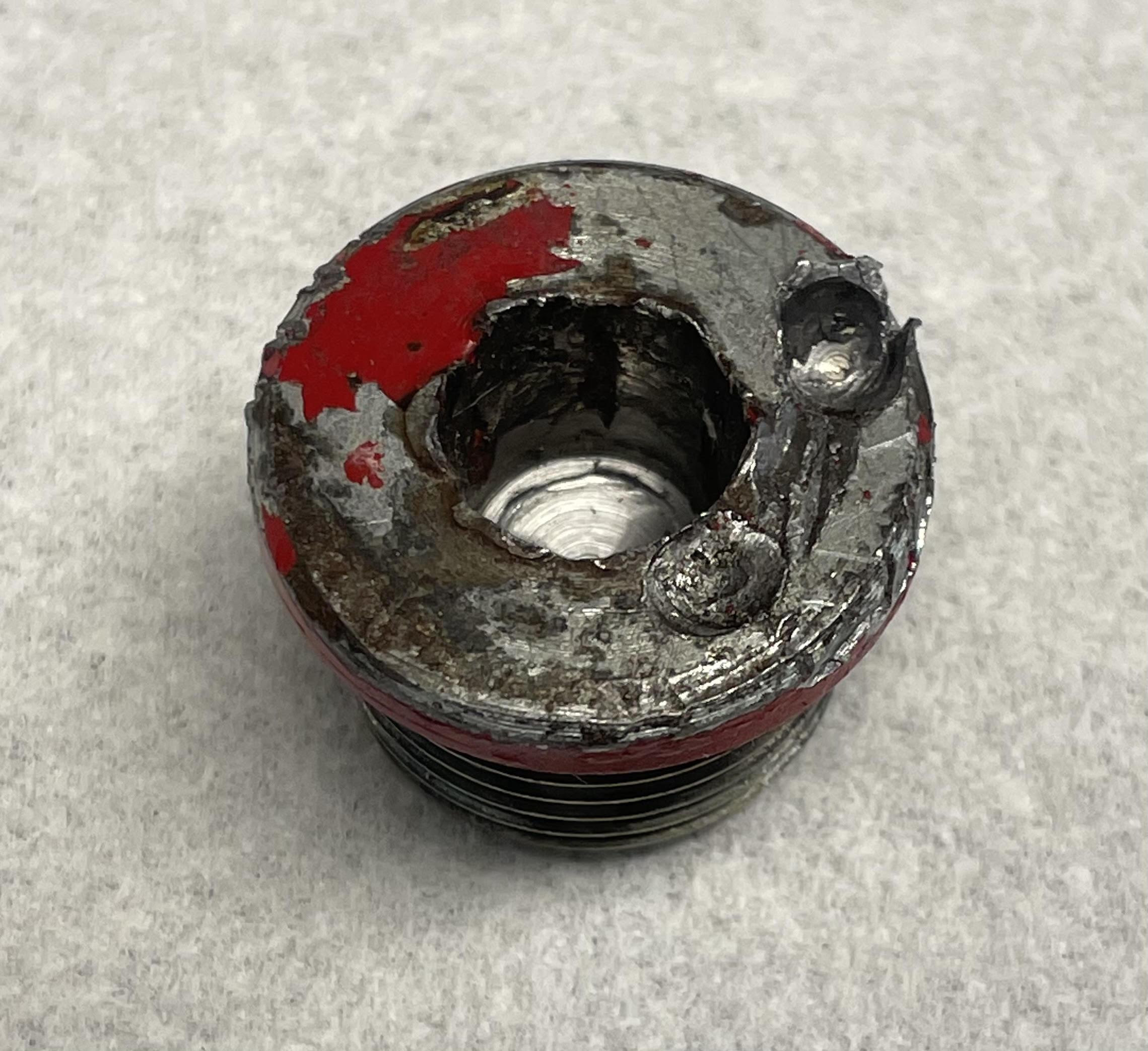

Just ran into this situation myself on my rear differential control plug...
Tried many "tricks," but what worked for me was about 24 hrs of liquid wrench, some heat from a torch, then rotational pressure from a punch and hammer. I drilled a shallow hole on the outer rim or the plug at the 3 o'clock position so the punch had a seat. Covered the axel boot and brake line with a wet paper towel and tinfoil, propane torched the plug for about 20 seconds, then did some CCW beating.
Didnt get to try the above mentioned socket reducer, and had no luck with getting a screw extractor to bite.
I have ordered some hex-plugs from EI.
Thanks for the help... love this forum!
