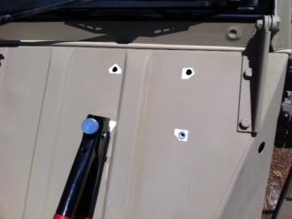

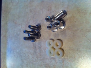

It was an easy install. The kit came with the bits including rubber grommets, connectors, etc. I added 4 long SS bolts and 4 nylon spacers to the kit so the panel does not sit on the body.
I looked into them and did not buy due to price. EI now has some that may improve your batteries or will extend the life of new batteries (if you have to replace your old ones
http://www.expedition-imports.com/produ ... ystem.html
Where the stuff came from and who uses it...
http://pulsetech.net/productinfo/productinfo.html
- Added long SS bolts, delryn spacers and inserts
- photo 2.JPG (27.3 KiB) Viewed 8054 times
- Drilled holes, painted holes and installed inserts...
- photo 3.JPG (23.4 KiB) Viewed 8054 times
- Installed panel and ran wire into cab and followed the wire harness to batteries...
- photo 4.JPG (30.45 KiB) Viewed 8054 times

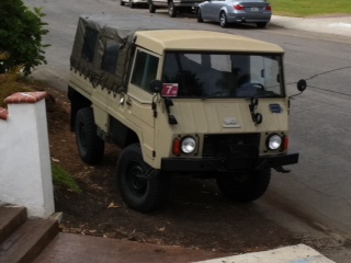

Finished version is inconspicuous, should not snag on stuff and seems to make a difference. ie my abused batteries actually are starting the vehicle. Downsides... It is another damn thing that I get asked about after answering someones question with, "No, the truck does not float"
- Small footprint...
- photo 5.JPG (32.17 KiB) Viewed 8051 times
