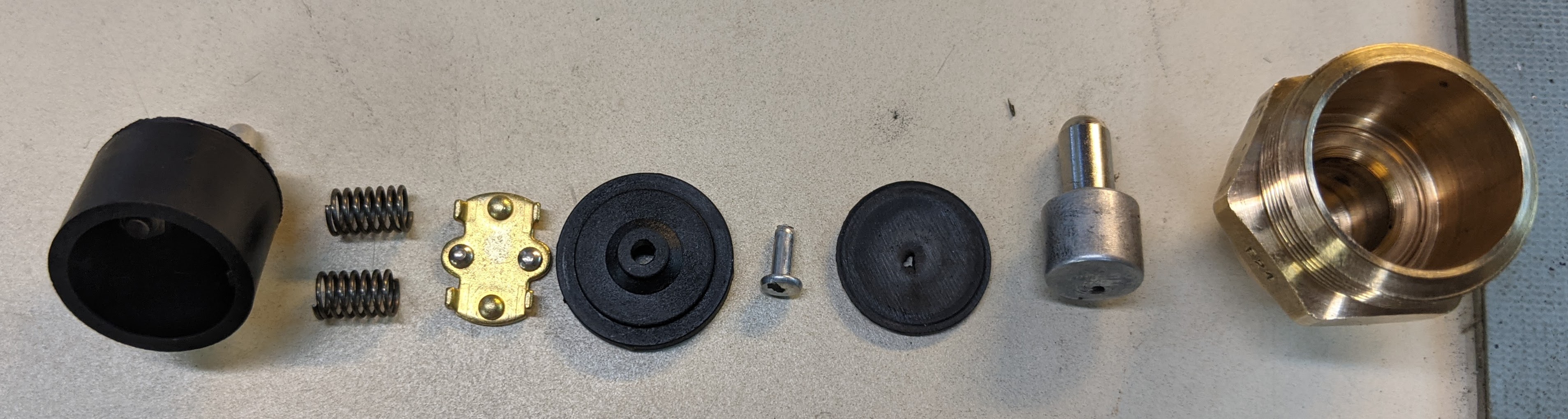

I'm cutting it open on a lathe today, and will report back what is found internally as the failed unit fails (shorts to the case) on every actuation as soon as it's depressed just a few mm.

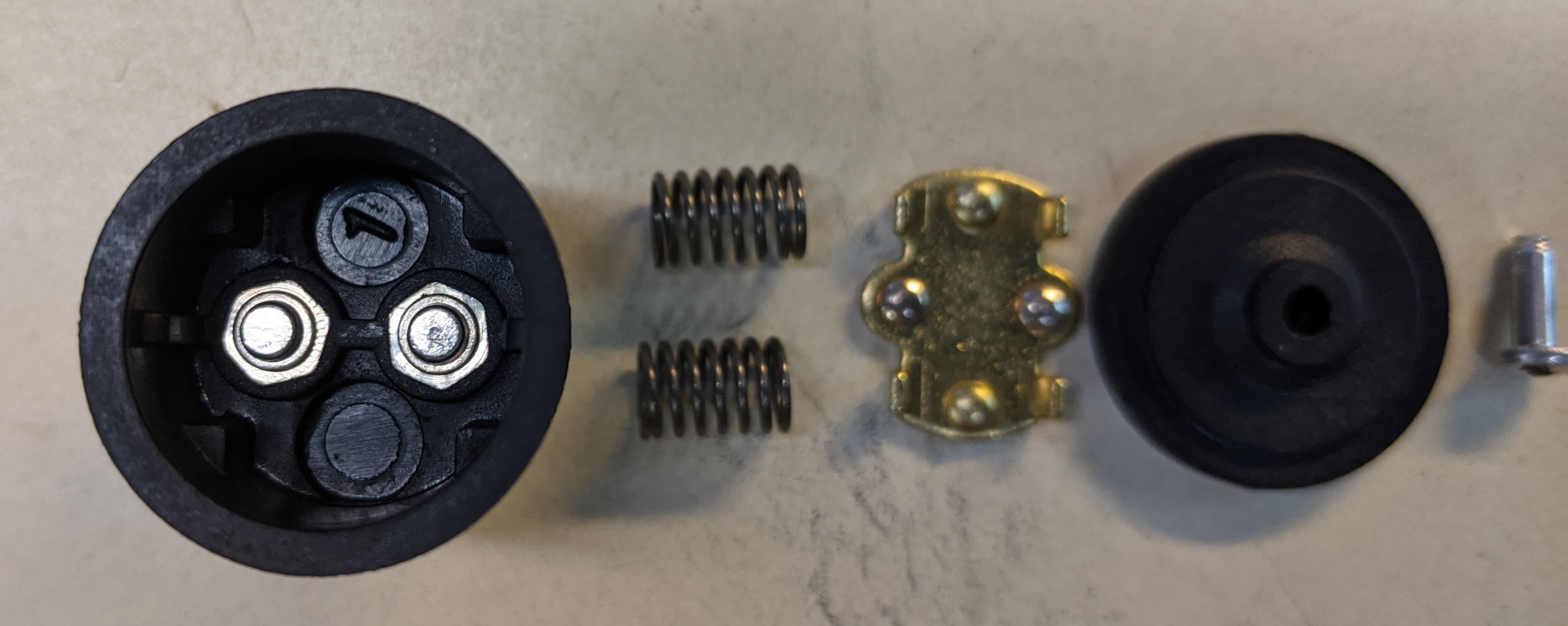

We cut the switch open on a lathe, and identified the failure, which can can be seen in the attached image as the hole in the otherwise solid rubber disc.
Digging deeper to understand why there is a hole in the disc, the conclusion is that the kit of parts from SAV results in the plunger being depressed too deeply, and compressing the rubber sealing disc between the two convex plungers which eventually erodes a hole in it.
The switch supports up to 5mm of overtravel, and can be compressed to a minimum of 15.5mm from the mating face. The supplied Cu sealing washer is 1.3mm thick. This dictates the concave pin in the transmission must be no less than 14.2mm at maximum outward travel. On my truck, I measured about 14.5mm, which is precariously close to the limit.
As a test, I measured how far the switch screws in past initial contact closure, and it goes in 2.5 turns before seating. At 1.5mm thread pitch, that's 3.75mm for a switch that has about 5mm allowed.
As a fix, I will install the new switch with an extra Cu washer, reducing the overtravel experienced by 1.3mm.
For anyone installing the SAV switch, I would recommend looking at how many turns the switch needs past contact closure (transmission in reverse) before seating. If it's close to 2.5T (3.75mm), I'd add a second copper washer which will reduce the turns by 1.3/1.5 --> just over 5/6 of a rotation.
