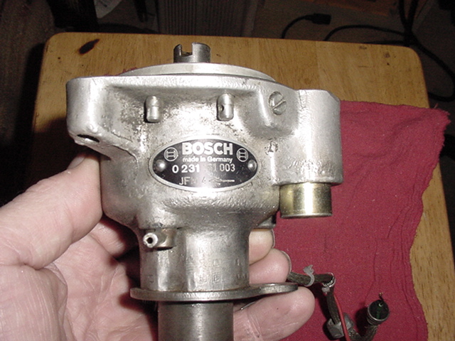

While looking at the distributer with the civilian distributer cap and adapter kit removed I noticed a number of vents in the distributer body. These vents can be seen in the photos I have linked to in Jim L’s “Distributor Recon” page on his web site.

On examination of the civilian distributor adapter plate I noticed that it covers these vent holes completely.
:idea: Being as I have a spare adapter plate I decides to alter one plate to uncover these vent holes and restore their functionality.
I can’t see the factory going to the expense of installing a vent let alone six vents for no reason.
Disclaimer – I have no factory / military distributor cap so I’m working on an assumption that these vents are not covered by the military style cap.
