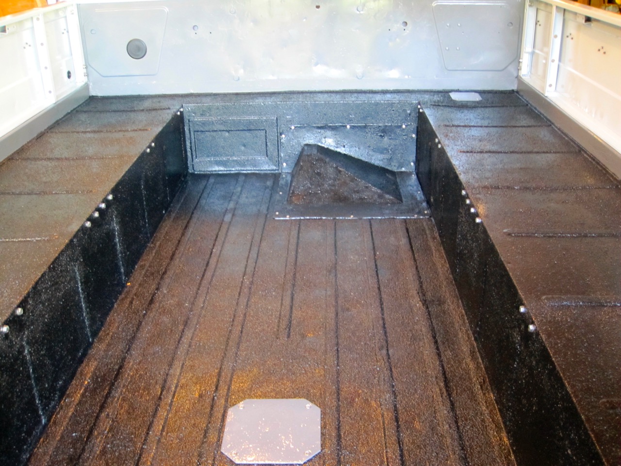

Of the five 710M's I've had I used bedliner in only 1. I first media blasted the areas with surface rust and then did a thorough cleaning with acetone or something similar. I then rolled and brushed the bedliner on the floor, side walls and under the rear seats. IIRC, I used Herculiner. It held up well while I had it.

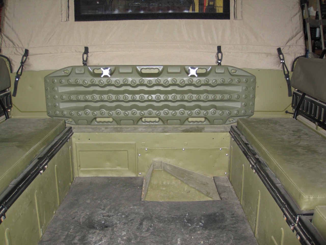

On some others, including the one I still own and have had for 14 years, I media blasted the surface rust, cleaned thoroughly, primed with a high quality epoxy primer and then painted with my desired finish coat. Typically with a semi-gloss or gloss finish for ease of cleaning. I then purchased what are called cow mats or horse stall mats at the local farm supply store and cut to fit. The 3/4" thick one was way to heavy but the 1/2" was easy to handle. The mats provide sound deadening and are easy to remove to clean under occasionally.
