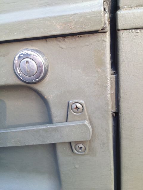

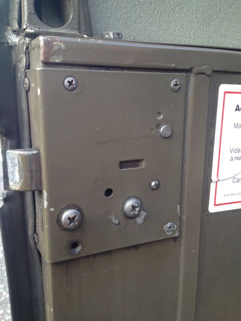

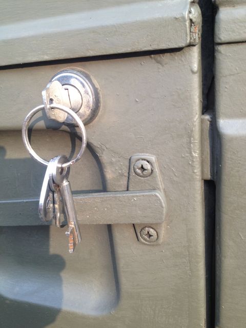

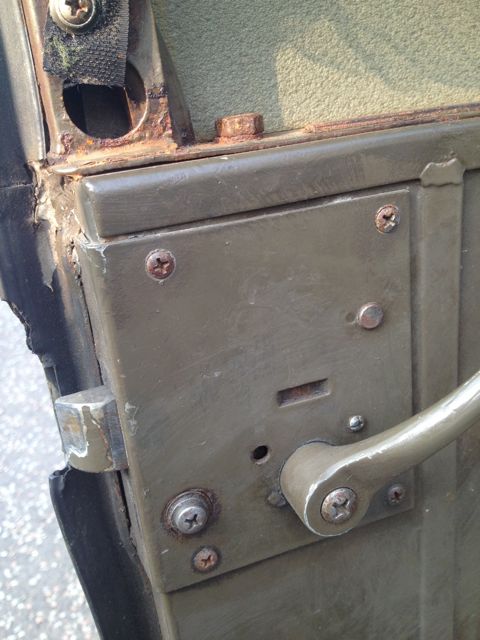

Looking at my Swiss 710K it seems front and rear door locks are identical except for the inside handle attachment / position
Outside front door lock
Inside front door lock
Outside rear door lock
Inside rear lock
Inside rear lock
