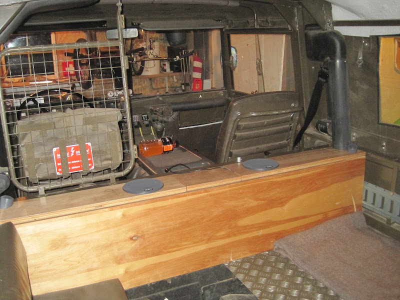

Here are some quick pictures. The more detailed ones will follow when I pull it apart to install the subwoofer.
the amp and crossovers are hidden in a space below the snorkel.

Nice job!McCall Pinz wrote:Here are some quick pictures. The more detailed ones will follow when I pull it apart to install the subwoofer.

OK, so if you copy this box, here are some tips- make it out of 1/2" ply to gain some interior room, leave about a 1/4" clear space to the seats so that you can still flip them up and down, and use the 4 big bolts in the bulkhead to hold the thing in place in case you tip over. The teeny little subwoofer is now in place and it helps with the sound, but isn't too "thumpy". Here are some pictures of the backside too, so you can see where the snorkel goes.

Spiffy! Can you post a picture of how you ran the snorkel through the bulkhead and into the intake?

I think the snorkel was posted before. Mine uses the factory 716 piece for the intake, then runs back and down through a hole in the bulkhead. The aircleaner is rotated so the intake points backwards and the flappy preheater is removed. Bernhard's is nicer actually- http://www.real4x4forums.com/PinzgauerB ... it=snorkel
