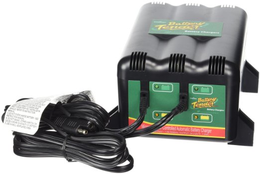

Posts: 1639
Re: 24V System Charging Help
Like aclark79 I use a Deltran Battery Tender but I found this one: http://amazon.com/Battery-Tender-022-01 ... ery+tender
It charges each battery independently which works out well since one battery always seems to need more charging than the other. It comes with 2 short wiring leads that you leave connected to the batteries. The Battery Tender than plugs into those leads when you're ready to charge. Since its a battery maintainer it can be left connected for long periods of time if you want.

pcolette wrote:Like aclark79 I use a Deltran Battery Tender but I found this one: http://amazon.com/Battery-Tender-022-01 ... ery+tender
I like that, I wonder if it would be worth switching to.
