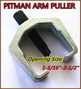

I tried a ball joint separator, a bearing puller but with no success. I eventually bought a pitman arm puller which worked a treat.
Check the size before you buy (this one may not suit).
