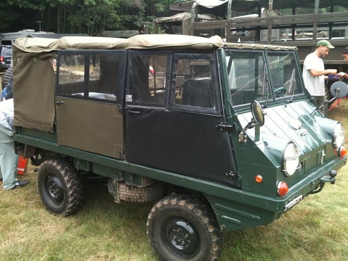

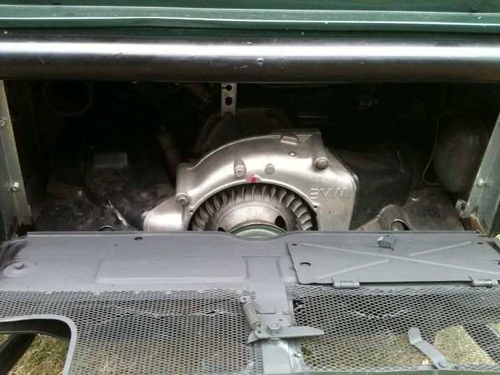

While in Weare, NH this past weekend I saw two Steyrs...a 710M and a Haffy. This Haffy had a BMW Isetta engine in it.

PLease Hafy people do share about this. Is this a owner mod or did some of these little trucks come this way? I am in the market still for one and know nothing about a BMW variant.

Re: Steyr-BMW Haflinger....
Owner mod
Would that not be WAY under powered??
Yes, it was an owner mod. The older gentleman who built it replaced the motor as he also owns Isettas.

I was thinking the same thing.....is this really an upgrade? Maybe just did it to say..."hey, I did it". :?:TechMOGogy wrote:Owner mod
Good morning to all,
I took the liberty to forward the link to this tread to a couple of the Yahoo Groups Microcar forums. The only response thus far is that the motor is most likely from a BMW700. Those engines are 697cc and put out 32bhp @ 5000rpm and 32 ft.lb @ 3400rpm in standard trim (single carb and 7.5:1 C.R). A factory sport model used dual carbs and a 9.0:1 C.R. producing 40bhp.
http://bringatrailer.com/2009/02/13/unr ... -bmw-700s/
It would be interesting to see more detailed photos of the conversion. Any idea who currently owns this truck?
The motor is from a BMW 700 which is the same as the one in my BMW Farmobil.

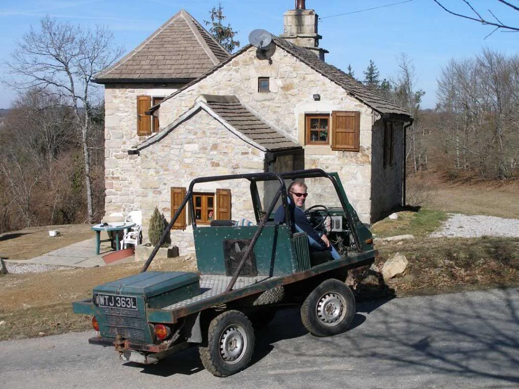

I love that stone house.....simple architectural perfection, much like our trucks!
