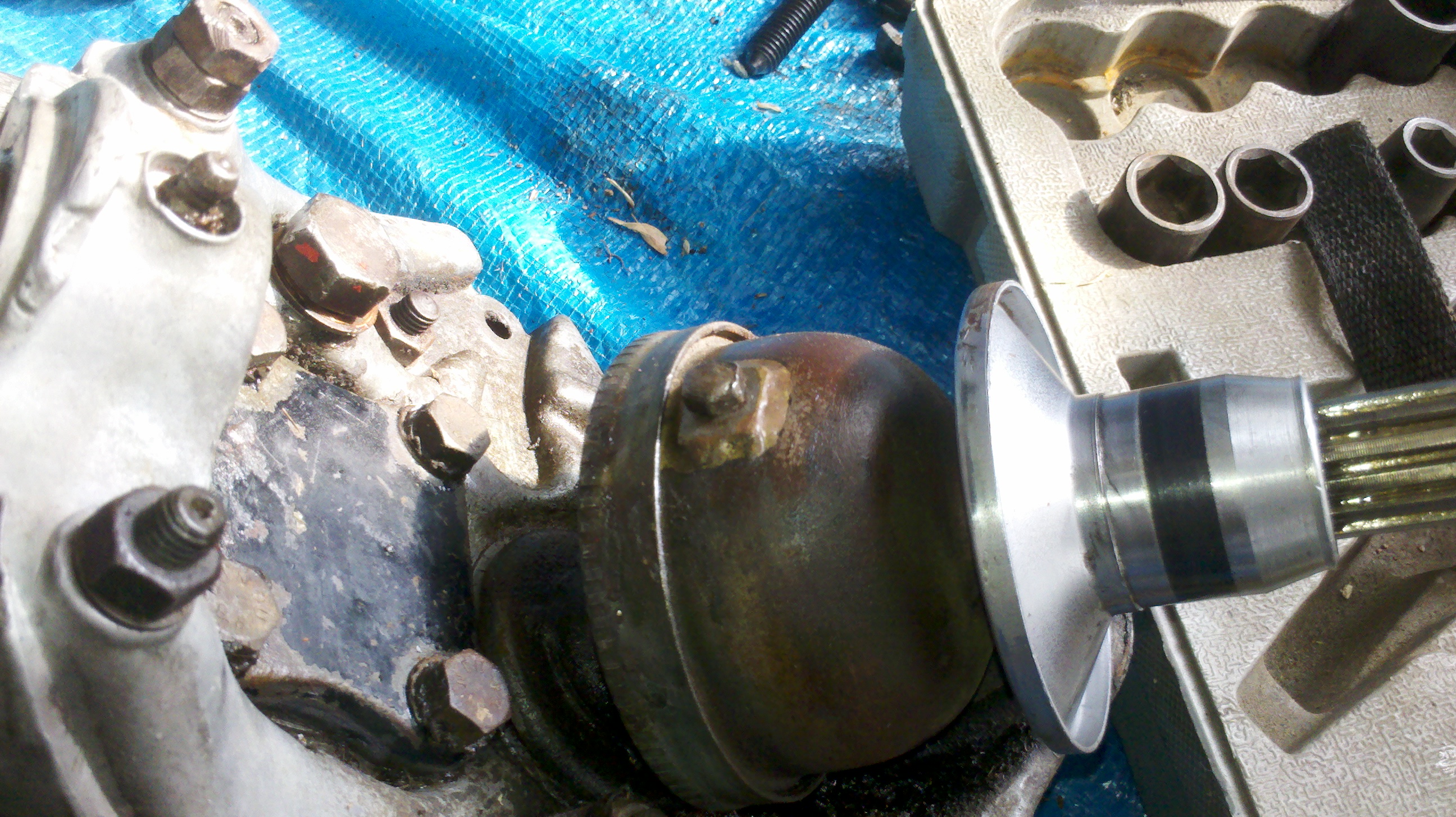

When I had my CVs out I drilled holes in them like this so new grease can be inserted without have to pull the front end out - tolerances are tight and the bolt cannot go inside the Cv but the bolt head needs to also clear the hub when the CV is rotating. There is no evidence my CVs are loosing grease so I have not service them in place.
Garry
