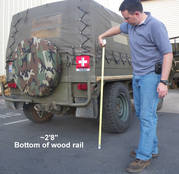

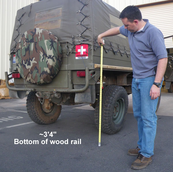

Here are two photos with a measuring tape:
Fully air'd down:
Fully air'd up:
Although its not the recommended method for changing a tire, the system can put a rear tire in the air. Here is a video of lifting a rear tire:
