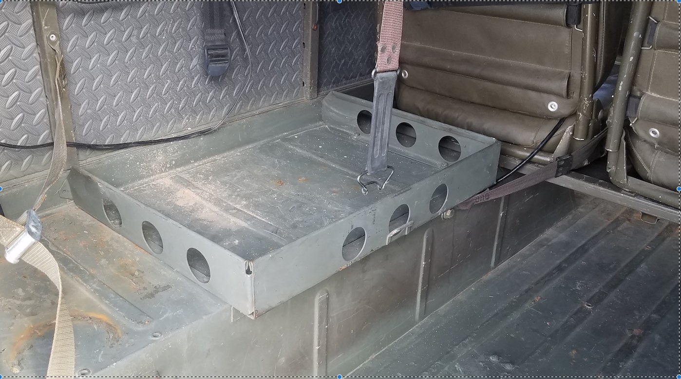

Does anybody know what was the original purpose for this tray in the back of a Swiss 710K?

I am lazy this morning so I won't pull out the parts book but I believe that is the shelf for the bag of snow chains. Good for you if you have all of the shelves. Mine had been removed but included with purchase. They were pretty rusty so it took some work to get them cleaned up and powder coated. Now I just need to figure out how to get them all installed. And find the time!!

Thanks for the reply. Yes I do remember now about the snow chains. Thank you!

The original purpose of the tray was not to hold the snow chains (they were going, I believe, together with the tool pouch in the compartment below the rear passenger seats, which replaces the "battery box twin" tool box on a 710M).
The rear compartment of the Swiss Army 710K was entirely devoted to "accessories" for the two US-made SE-412 radios (RT-524 is the US designation).
As I only sat in a 710K for a mere 2 weeks in the summer of 1994 while in the Swiss Army, then our unit transitioned to Puch Gs, I don't really remember it that well... then I found the link below, which is a scanned copy of the Swiss Army regulation for 710Ks:
https://www.hamfu.ch/_upload/58.144_d-K ... 78-web.pdf
If you go to page 15 of the document (it is numbered page no. 6 on the document itself), you have the whole setup in picture:
- The big item in the middle under a cover is a power generator (pictured on its own three pages later),
- On the right-side wheel well there are I believe four coils: one of power cord to connect the vehicle (or the radios, cannot really remember) to the power generator, and two of phone line to link the the remote and the radio-side elements of the GRA-39 remote sets, with the two GR-39 remote sets in pouches on the right side of the top tray (They allowed the radios to be operated away from the vehicle, typically in a command post). The last coil was a power cord and allowed the radios to be powered by the mains in case you're not in the middle of nowhere.
- Between the generator and the coils are two MX-6707 antenna bases (upside down).
- Between the generator and the left fender is a long bag with the top elements of the field antennas (the main masts are carried on the front of the truck).
- I don't remember ever using the square-ish box on the right (it probably contains gas and oil for the 2-stroke power generator, which later on they replaced by an extra jerrycan of 2-stroke mix, as we definitely had some extra fuel for the power generator).
- The bag in the tray, just behind the seats has "FA-412" written on it, and it contained the upper and lower guy lines, pegs, the mast base, a hammer to drive the pegs, the mast crank, as well as the antenna cables (two coils of 20 meters per antenna, if I remember well). There is a picture of a raised antenna on page 71 (page 62 on the doc, figure 34). In my memory there was one long bag and one "FA-412" bag for each antenna (so two of each per truck), but seeing the picture it was probably just one bag of each containing elements for two antennas...
- The other item in the tray (between the FA-412 bag and the square-ish box) may be an early version ('70s) camouflage net. When I served in the '90s we had different ones, with rubber canvas "foliage", which usually was in the middle of the top tray.
I hope this helps shed some light!
