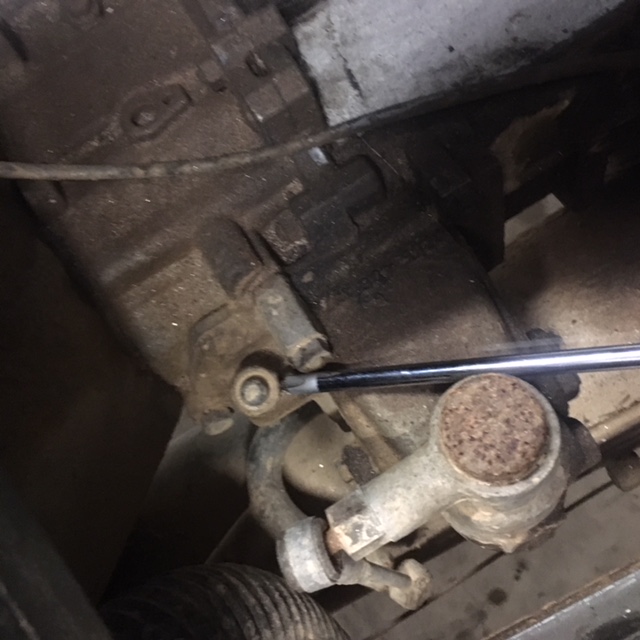

Here is a picture of the transmission vent. This is taken through the inspection plate at the forward end of the bed. The breather is right there at the tip of the screwdriver.On my truck with 33"tires and no load it is about 30.5" above the ground. I wonder if this sets the factory wading height? I am surprised there are no reports of water intrusion on the forum.

Took the dog house off for the first time today. I'm assuming these are breathers, and I'm assuming they aren't factory. Would that be a reasonable assumption? And why did it rotate my picture?

That looks like the spot where they are shown to be in the owners manual.
