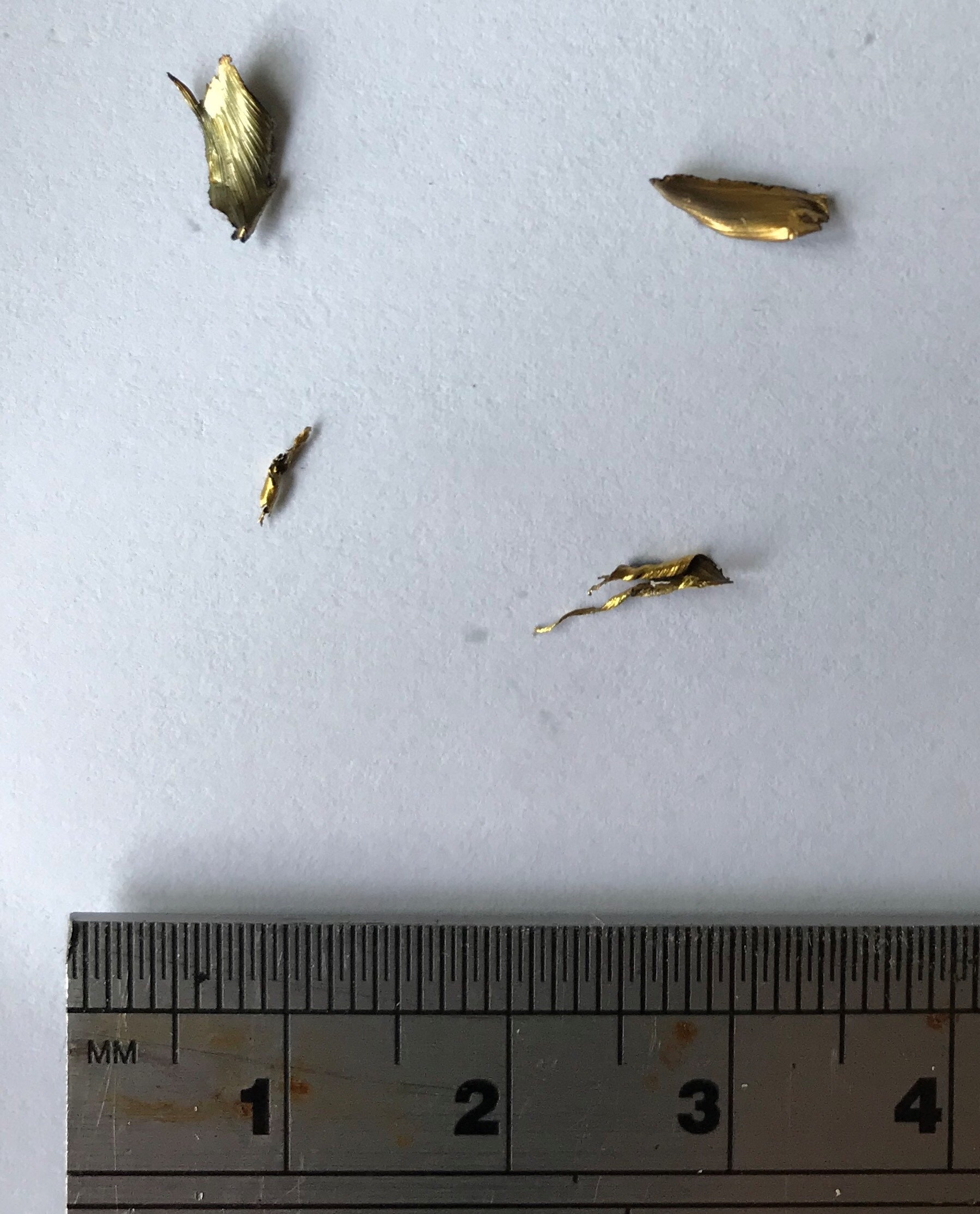

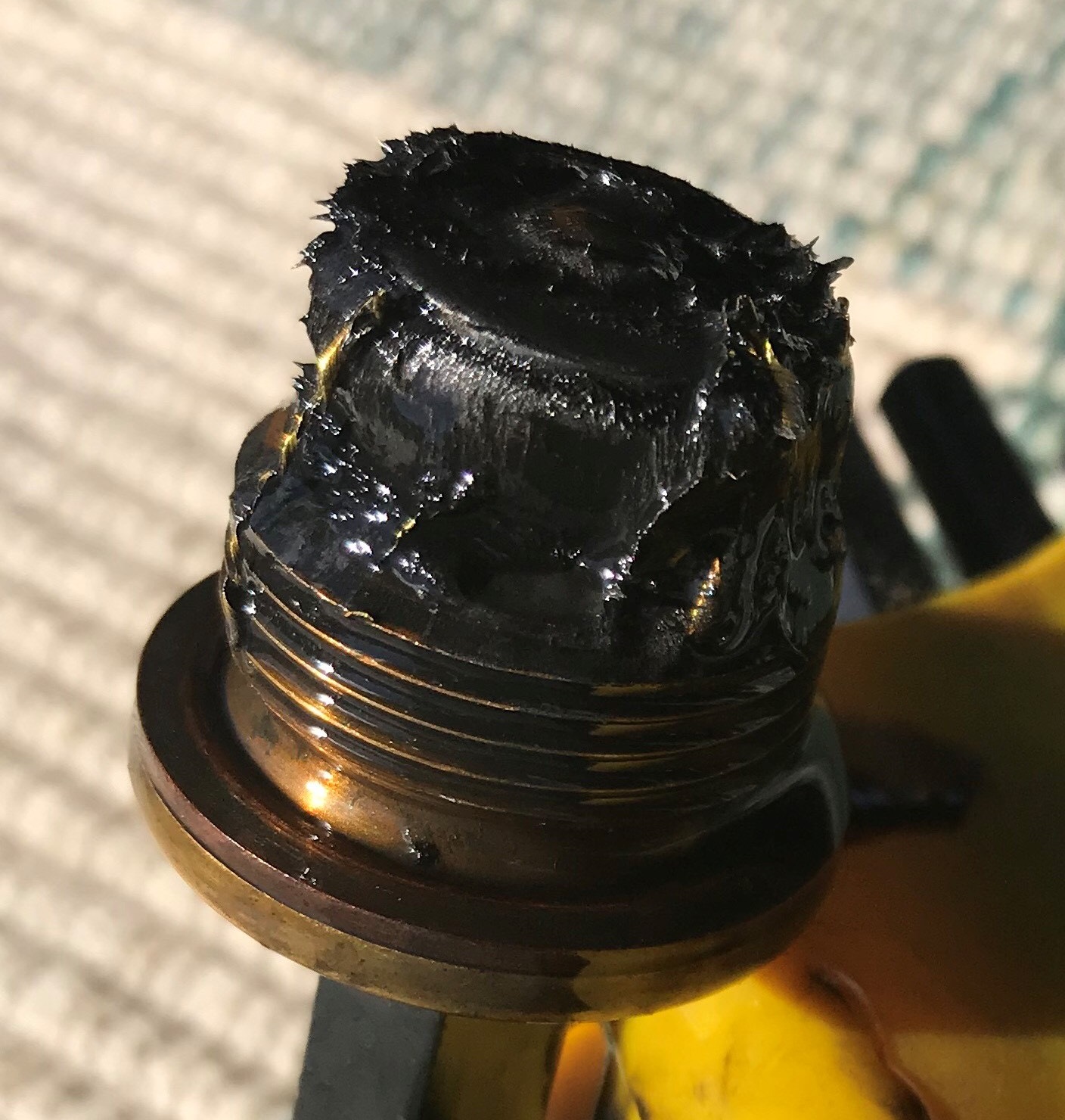

Re: Scary lock-up on motorway
I drained the oil from the front diff and this is what I found. Very fine steel filings, and some larger pieces of gold coloured filings. Is this normal wear? Only about 1 litre of oil drained out, but at least 2 litres went in on refill. There were black streaks through the old oil, fine iron filings I imagine. The gear oil was 80W90 GL-5.
My front differential was stripped down and the following reported:
One of the pinion bearings has seized, and the inner gear has seized to the shaft and picked up. Also all the seals were leaking oil, so needs a set of seals.
Repair is underway.
Repair is underway.
Sounds like someone ran it without oil or not quite enough.
