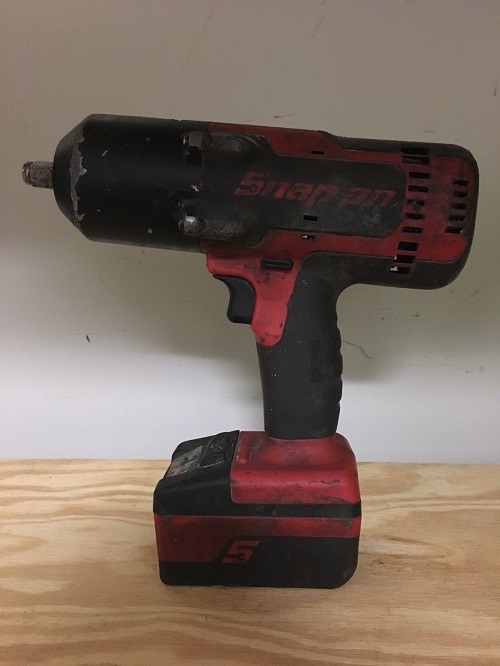

Very cool set-up. I carry this baby and it's amazing how powerful it is.. enough to do remove and mount any bunch of tires I have. I found a used one for a great deal after seeing pro mechanics using them in a big tire shop.
