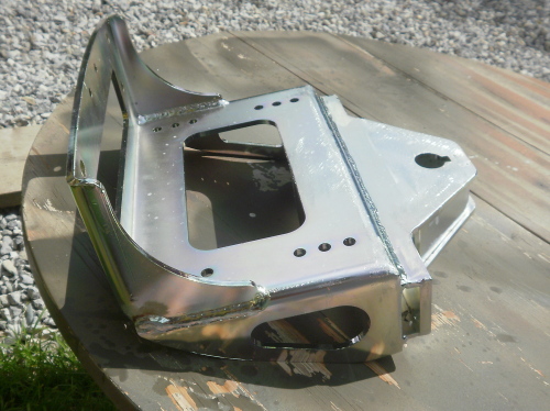

I was poking around on the internet this morning and came across this winch mount made for the Pinzgauer. It is made in Germany. Below is a link to the page:
https://pinzgauer-ersatzteile.webnode.a ... uer-vorne/
I've purchased from this vendor before and was not disappointed.
Anybody on this forum who has personally used this winch mount, knows someone who has one, or any other information regarding this particular set-up, please chime in.
I've attached a photo of it taken from the vendor's website.
Thanks,
Scott
German winch mount
German winch mount
- Windenhalter.jpg (122.43 KiB) Viewed 5430 times

Re: German winch mount
Lads
The reason for that device lies within our legislation:
Anything you modify on a vehicle that is registered for traffic on public roads has to be TÜV approved.
Moreover, if you weld something to the frame the welder has to show his welding diploma.
Currently in Germany most Pinzgauers are registered as "historical vehicle" giving them discounts for insurance and road tax, and allowing them into city centers, which are currently restrited to vehicles wih certain emission control levels.
This winch mount bypasses that restriction. It uses the front towing mouth as mounting point and is held by the bolt; thus no modification to the existing vehicle, and it can be removed without a trace .....

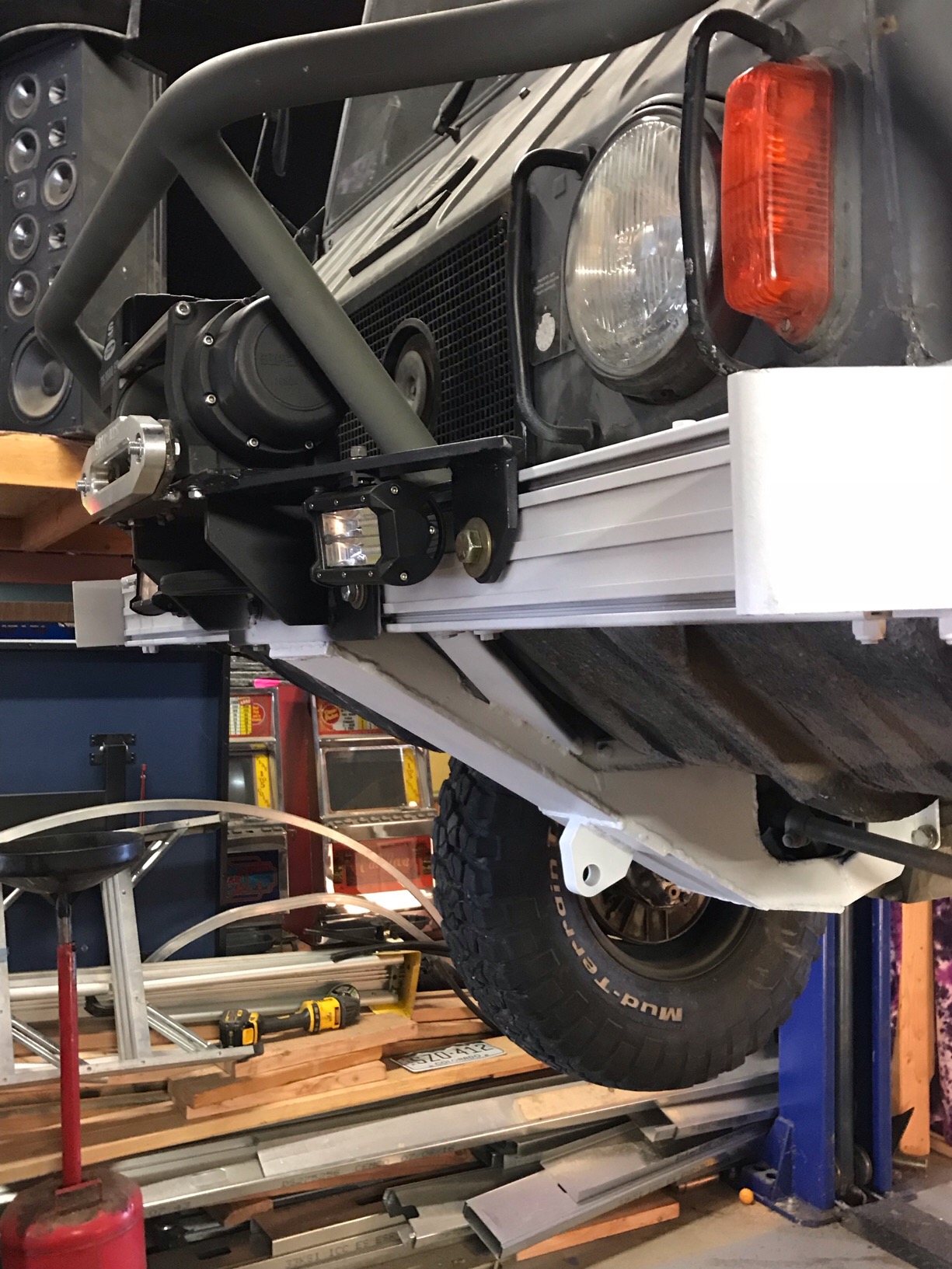

Go with Andre
Here is one of his mounts
Not my truck but I have same mount

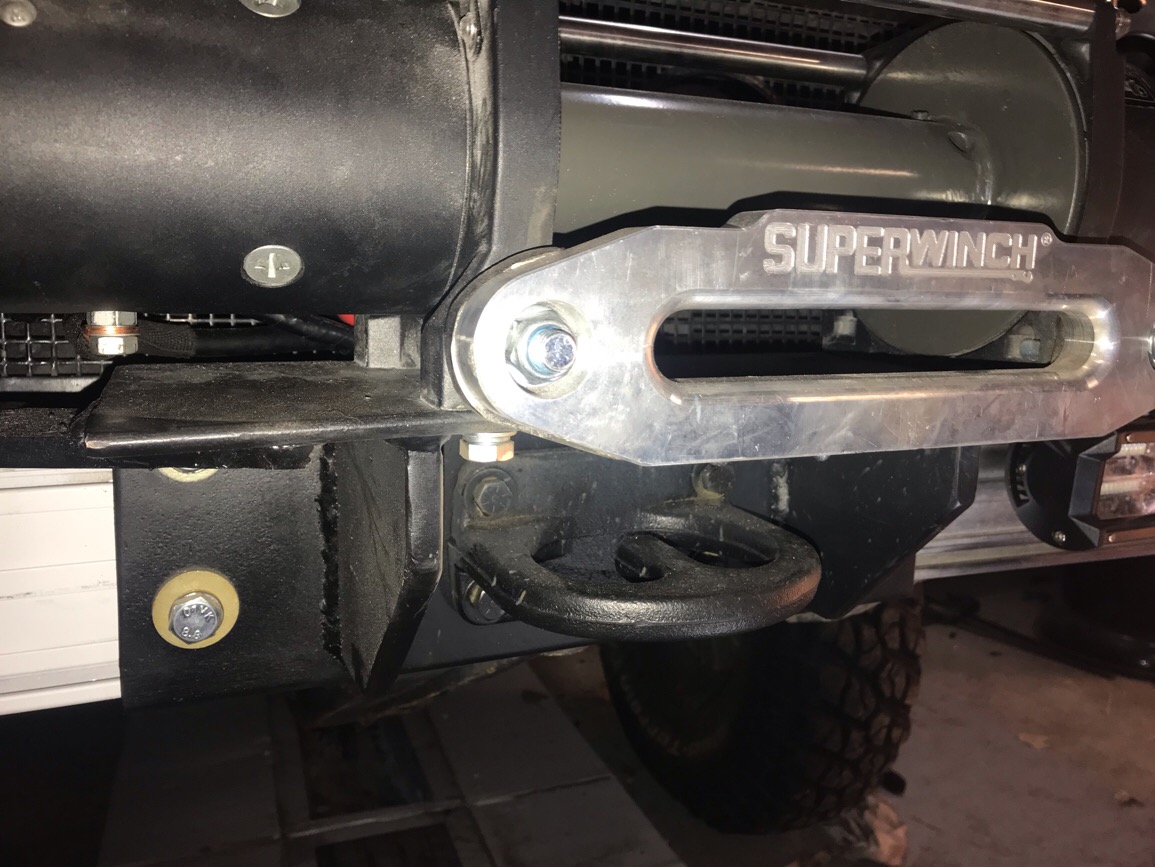

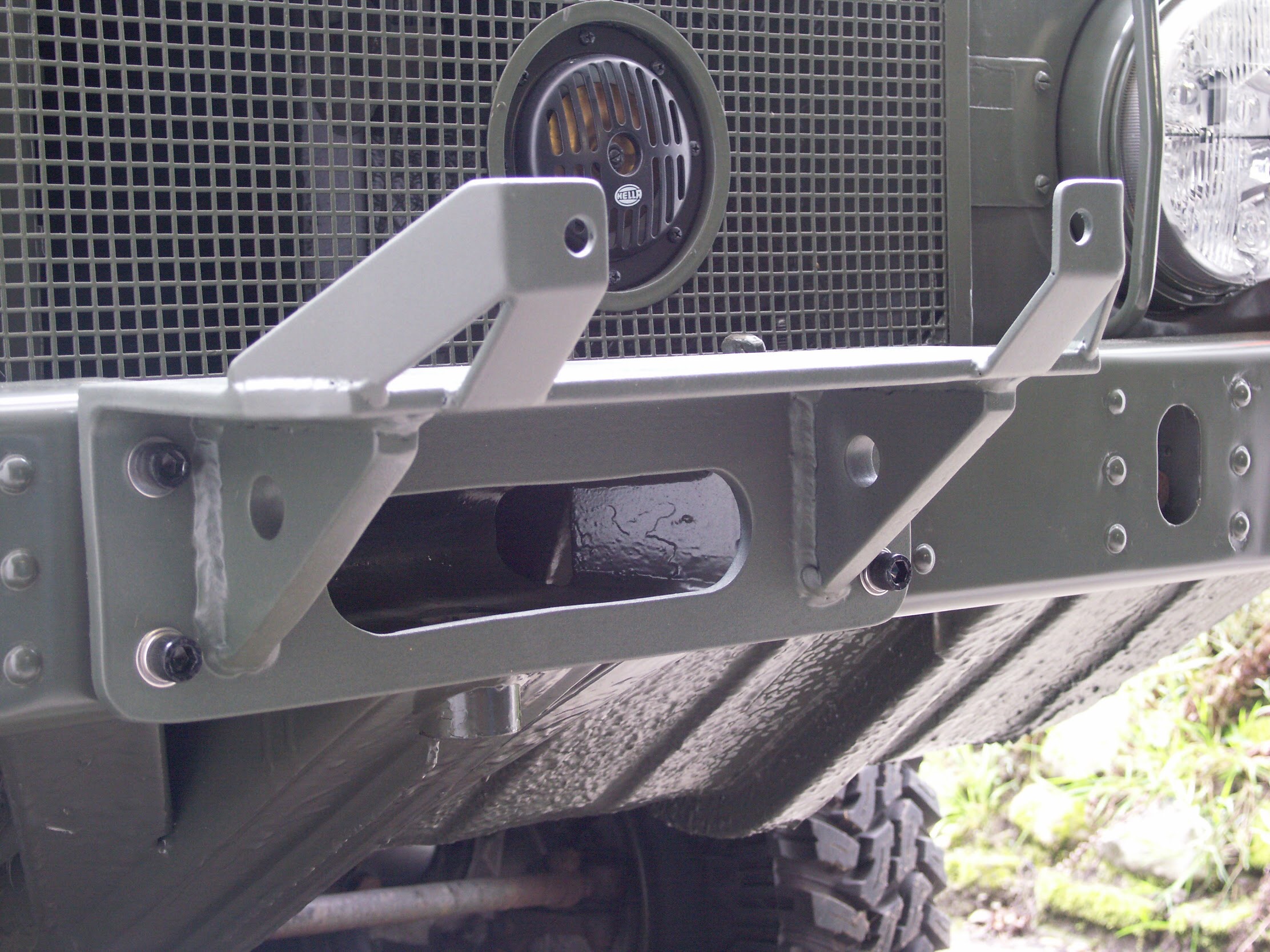

When I made my winch mount, I re-inforced the center frame member with 1/4” steel. Also added an anchor point for a double winch line pull. Winch mount used existing holes.
- 83D90FBE-94C9-408B-AC43-12552D52F8D0.jpeg (230.11 KiB) Viewed 5138 times
- F0F43C10-9E2B-48DA-B909-AC1D3FE9F0B4.jpeg (469.01 KiB) Viewed 5138 times
