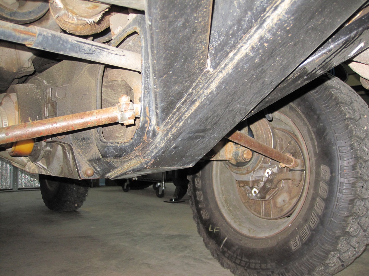

Your thoughts of reinforcement reminded me of a 710M I owned for a while that had additional bracing to the front main framework. I don't know who did it but it almost looks like it may have been done at the factory. Here's a couple of photos:
Re: MRAP 24 volt Warn winch
Patrick CWR was a big proponent of reinforcing the front when a winch was fitted. The above looks like the kind of supports he used in the early years. He later had plates made that were welded to the sides of the nose piece to make it even stronger. Seemed like a lot of weight to add to the front especially after winch install.
