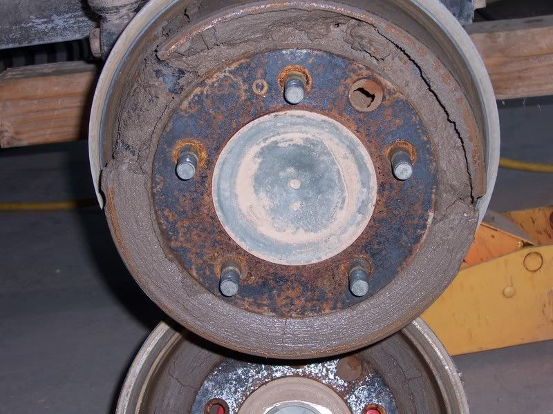

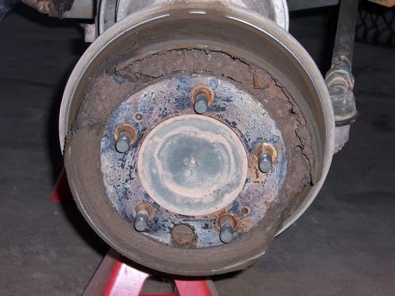

Thought it would be a good idea to let those who are either new to the pinz community or have not yet had the opportunity to play in the mud what they need to do when they get home. I know this has been covered but it was before the crashes and some of the newer owners may not have learned the need to clean the trucks up after a weekend of fun. The cost savings and safety aspect I thought make it worth posting again.
Here are some pics of what happens to the brakes when you play in deep mud. Not a big deal just needs to be cleaned out before going to far or the metal parts will rust and the shoes will wear out prematurely. These are pics of my 710 after some mud fun. Wish I had taken pics of my 712 after being there, the drums were completely packed.

Good thing you didn't have to drive home! :wink:

It really would not have hurt anything to drive it. The biggest concern would have been stopping it. I drove the 712 home and it was much worse than this trip with the 710.
