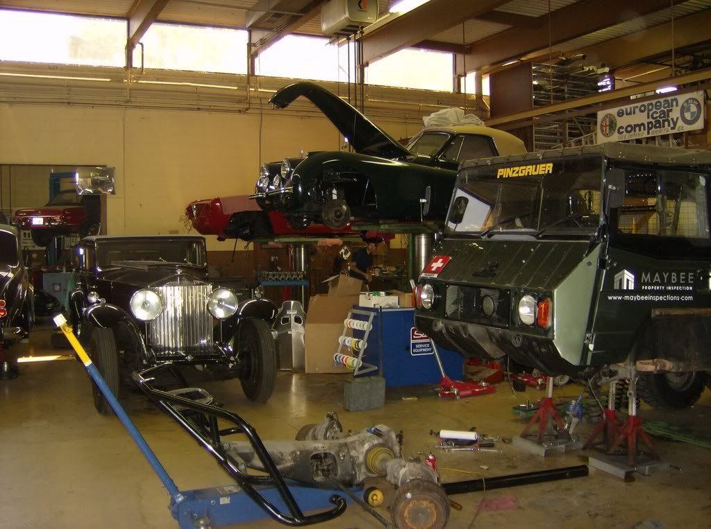

[img] http://i177.photobucket.com/albums/w205 ... end001.jpg [/img] I disagree I think if you are close enough to drive to a pinz mechanic than sure take advantage of it.But there's nothing nicer than being able to take it to a local repair shop and have the repairs done. There surely a european car shop in your area. I take mine to European car care here. He tunes my carbs for the seasons and check valves and so on. just remember once you take the carbs off to ship them your going to have to sync them when you put them back on some times its just nice having it done locally. If you don't have a set of manuals that would be my first by I don't imagine Scott or Jim like phone calls from a repair shop because your to cheap to purchase the manual. Just my two cents i really in joy taking the pinz some were locally most of the time they seem to find parts or have them made locally as well. from what my mechanic tells me is that the pinz is relatively easy to work on.
