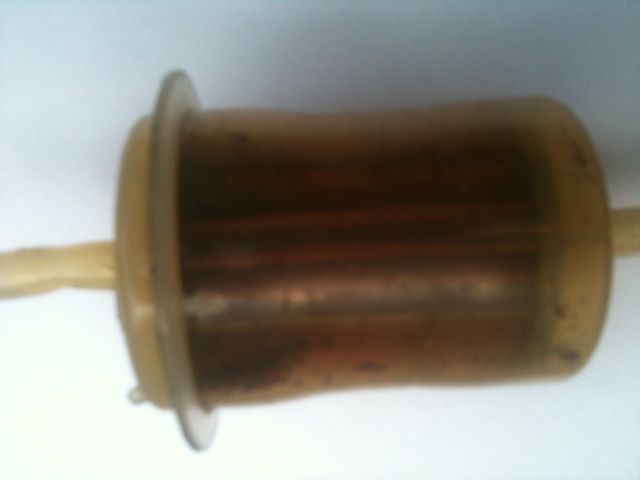

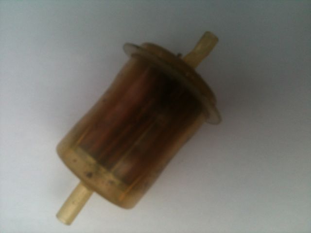

Pinzgauer let me down for the first time today and would not start. turned over but not firing at all.
Although it was a bright morning it had been damp with a heavy dew so I put some WD-40 in the distributor and checked the plug cables. Still no start.
Well I guess I was lucky, the sun was shining and I was at home and had a free morning.
I checked for spark, removing one plug and held against the engine while turning over... spark good.
I checked fuel by removing the fuel line to the carbs, held it into a small cup and turned the engine over... NO FUEL.
I looked at the fuel filter and it looked clean. I saw the gauge showed empty so I put the spare can in the tank 20l, still no start.
I took the fuel line off the front of the fuel filter and blew back into the tank, heard the bubbles so knew that line was not blocked.
I took the fuel line off after the fuel pump, fed it into a cup and turned the engine over... NO FUEL.
I took the fuel filter off, now I saw the problem, on the underside of the filter all sorts of debris had gathered including some dreaded red flakes.
New fuel filter fitted, a lot of turning over on a very tired battery and she fired up. Ran smooth as ever.
Just glad I didn't have to do it all on a mountain in the middle of winter. But was glad I only used tools and parts that I normally carry in the truck.

- IMG_1512.jpg (18.6 KiB) Viewed 4677 times
- IMG_1510.jpg (18.74 KiB) Viewed 4677 times
