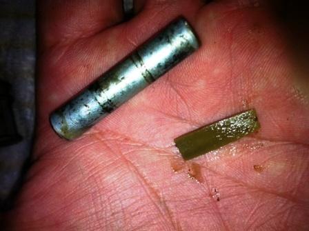

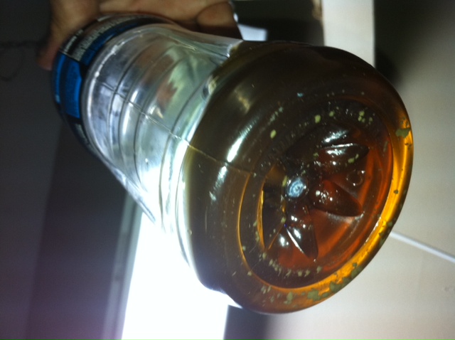

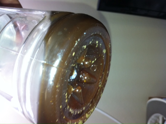

As mentioned, after breaking one of the locker levers, I decided to tackle the repair, the replacement of the elbows and T, and to then flush the lines. Last night I sucked out the hydraulic fluid in the reservoir and placed it in a clean plastic bottle. What was pulled out was pretty scary looking. I've attached photos. You can see the color of the fluid is almost coca-cola color and there are yellow floaters in it. Now this was from the reservoir at the top of the system.

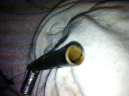

I then pulled off the tubes, elbows and T and took it to the work bench to work on it. After removing the elbows and the T I looked at the aluminum pipes/tubes connecting them to the lockers. Check out what I found.(Pics below as well). The tube appeared to have a yellow solid in the bottom of it. After taking a pick, you can see the solid piece that came out of one pipe and the pile of solids that came out of the other. I now have a major concern about what is on the lower end of the system and if this is why I had trouble engaging one of the pistons. I've only had the truck a year and haven't had an occassion to fool with the hydraulics until now. I have no idea when she was last cleaned. But, from the looks of it, maybe never.

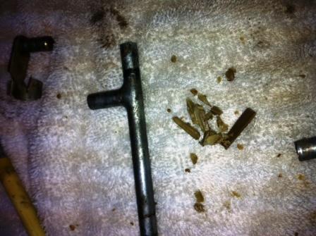

Here's pics of the rest of the solids taken out of the tubing.

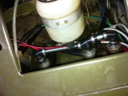

And here it is with the elbows and T replaced and re-installed.

Yes I went through the same thing and that is what happens to brake fluide after sitting for a decade in a unused system. The entire piping system will have that solidified brake fluid in it, I flushed out my whole system, brake lines and hydraulic lines.
