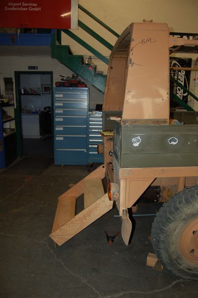

For tour operators that put a lot of passengers into their vehicle we were looking for a better option. Here it is coming out of fabrication.
A sheet of plywood to work on conceptual design.......first
Scott
Scott

From Conceptual we went into fabrication.....

looks nice and off the floor like the accordion RV steps I have seen installed. How does it make up for height variants of the ground? I assume a tour operator would be parking on fairly level ground when loading and unloading anyway.

The ladder will flex a bit, but in this case the customer will be loading and unloading on reasonably level ground. If someone were expecting majorly uneven ground then you would use a single point of contact instead of 2 points of contact. Personally I prefer two breasts coming off the back of my truck versus one.....
