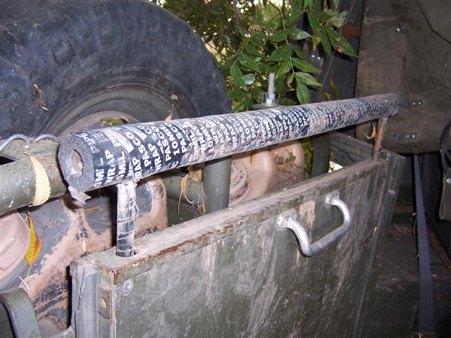

Years ago I made a simple (to me considering what I do for a living) fix for the rear door.
I used a piece of 3/4 inch copper, two 3/4 x 3/4 x 1/2 tees and two 3/4 caps. I made a setup of the copper, insulated it with rubber insulation and wrapped it with poly tape. Soft yet seals up the back well.
obviously I push it all the way down, just lifted it up a bit so you could get the idea.

PhilH
Posts: 30
Joined: Sun Aug 28, 2011 2:30 pm
Location: Tennessee
Re: Back Window
Post by PhilH »
Thanks. That's a great idea.
