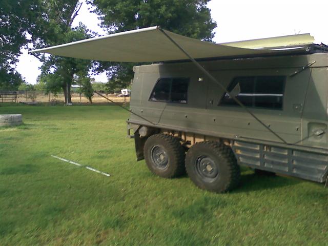

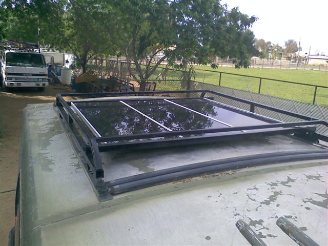

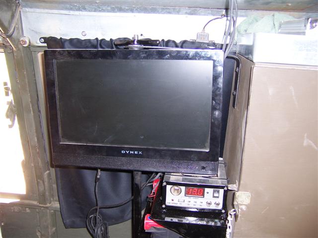

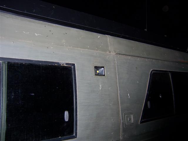

I found some nice compact LED lights that I liked for my Pinz. They are 900 lumen (= to +- 70watt bulb) and cast light at 140 degree angle. I mounted the side one just a little inside the side panels so as not to get hung up on branches and the like. The rear one I just installed under the oil can. I also stumbled across a solar shade screen that I thought would work well for a canopy. It came in an aluminum housing, I really did not want the vinyl bag units as I did not think they would hold up. Finally got around to permanently installing the TV in my pinz and the solar panels to drive all the 12v appliances. I got lucky this week and picked up an Engel Fridge/freezer (Mark's has been working so well I had F/F envy).

Once the Fridge/Freezer is in its permanent place I will get a pic. I want to make a cage to hold it in place while I am having fun with the truck.

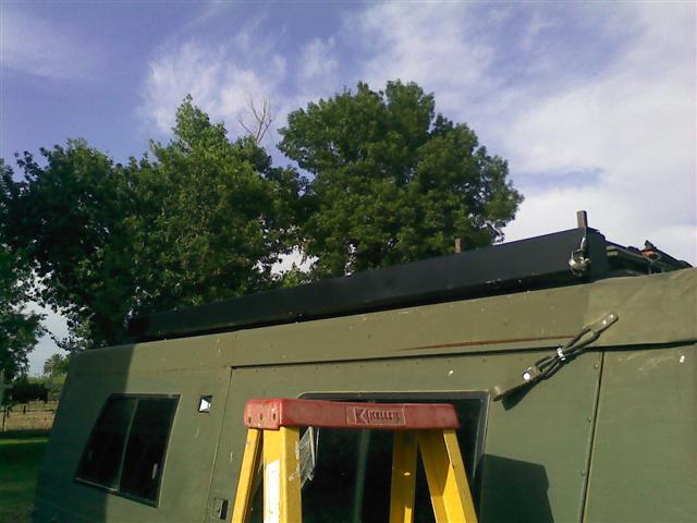

What holding the awning at that angle? Did you build the enclosure? Where did you source the awning itself?
Re: a few more additions to my Pinz
The awning came from Costco. It is sold as a shade curtain for a patio. It comes in an aluminum box that is open on one side. I made the door to cover the opening. The box itself is a "C" channel which I made brackets for. The nice part is I set it up so I could leave the brackets on the truck and just slide the canopy housing off if ever need be. I removed the factory installed weighted end and put a length of 5/8ths metal tubing through the seem. This I drilled to accept the supports. I can either stand them up straight and use a few guy-lines or as in the photo just set them on my side rails. I would need to either put some weight on outside edge in a wind or tie them down with guy-wires. The rear unit I made, I just use a counter weight and it works really well. This is just a larger version.
What I like about this unit over the specific built units is it extends out 8' from the vehicle. I can also set the height of the outside if the sun is low on the horizon.
Sounds like a lot of work but from start to finish I only have 3 hours in the install, including painting.

Where did you get those side LED lights from? They loiok interesting for some projects I am doing. Let me know if you can...
http://www.ebay.com/sch/laurel-beads/m. ... ksid=p3686
they are the 10w (more like 36w) 12v led lights. Work great and put out a tremendous amount of light. I was planning on two per side but only really needed one since they gave me enough light.
