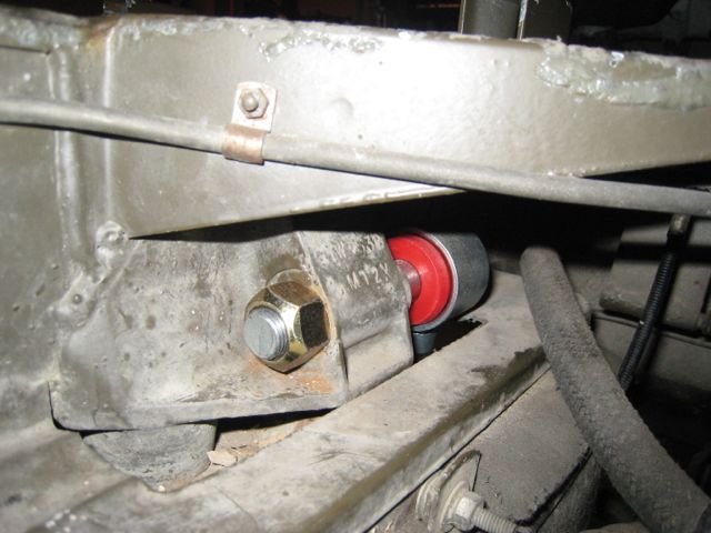

I've done this a few times and it's never been easy but here goes:
-Optional but a good idea: jack up the front end, put on jack stands and remove the front wheels
-Remove the doghouse
-Passenger side - remove the coil and mounting bracket and move aside any wires that are in the way.
-The nut and bolt for the top of the shock are now fairly easy to get to. A good box end wrench and socket with ratchet are all you need. The nut is a self-locking or NyLoc nut.
-Check over the bolts for wear and corrosion. They're usually okay but if not McMaster carries some of them and EI or SAV the others.
-When re-installing it's sometimes a bit difficult to get the top eye of the shock thru the opening in the body, especially with the steel sleeve in the bushing. Keep trying, it does finally go in. Now extend the shock and insert the bottom bolt to hold the shock in place. Using a large screwdriver or small pry bar you can now work on installing the top bolt before tightening the bottom one.
-Driver side - this is the tough one. The nut and bolt are the same as the p/s but are hidden under the lip of the engine compartment. Remove the lower tin below the fan for better access.
-A long micro ratchet with socket and a combo wrench should do the trick
-If you're a contortionist it helps :) but you have to hang your head partly into the engine area to see what you're doing
-No trick to this that I've found, just patience.
This is the driver's side but with the Doetsch rebuildable shock shown (since replaced).
Good luck!
