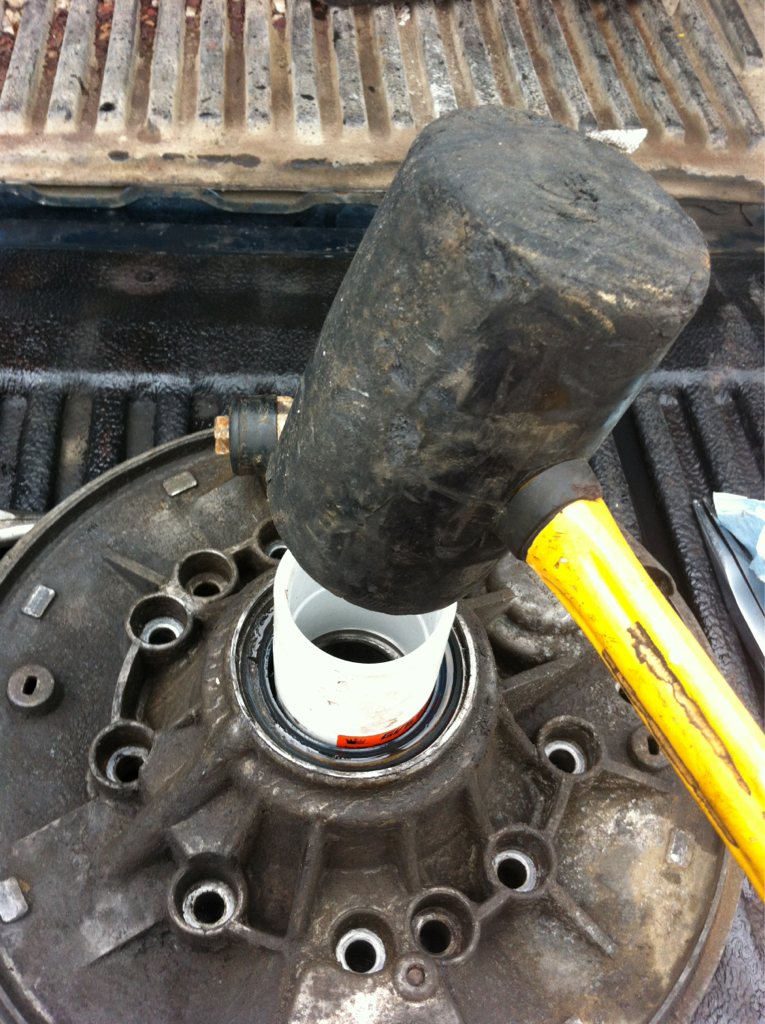

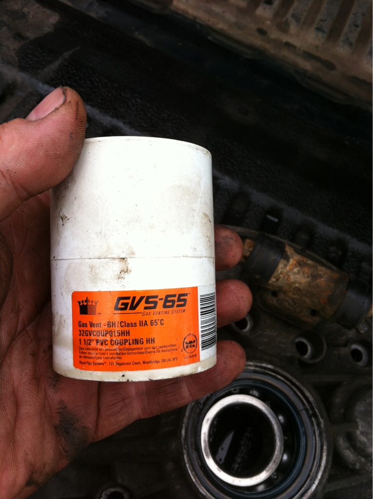

After removing the retaining ring, I used a piece of PVC I had laying around to remove the bearing. I am not a fan of removing a bearing using the inner race, but since EI did it.... :D . It didn't take much and I used a rubber mallet.

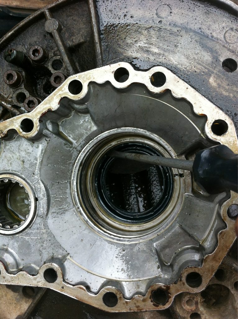

Now to remove the seal. I used a flat head screw driver to knock it out from inside, then pulled it out.

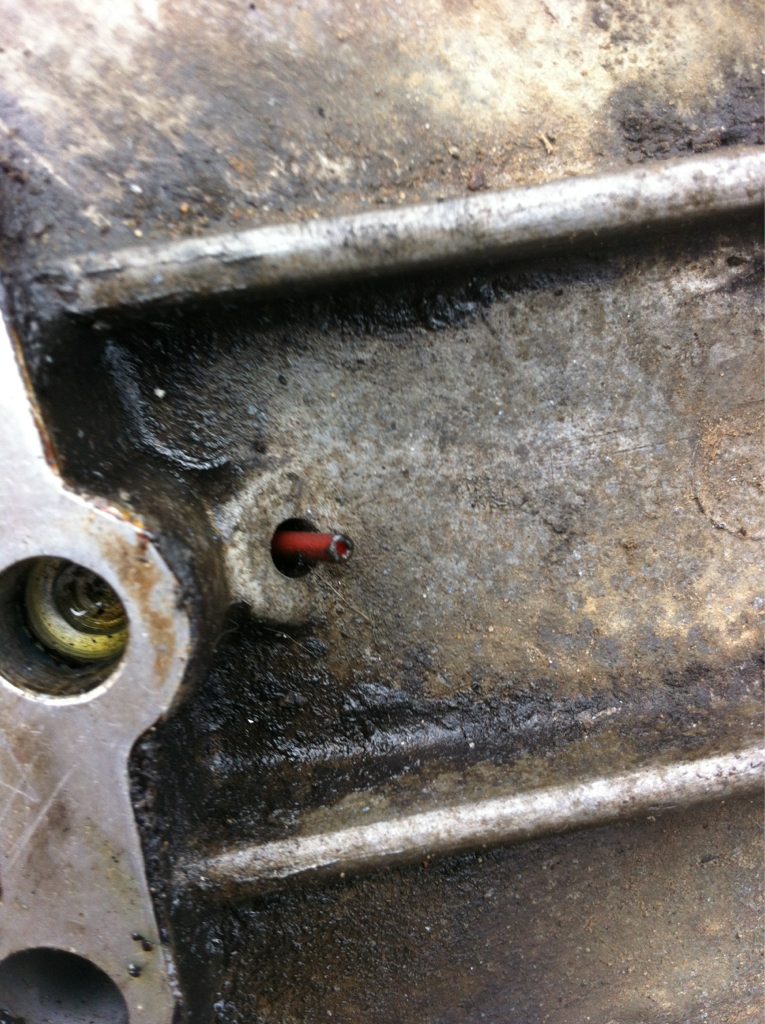

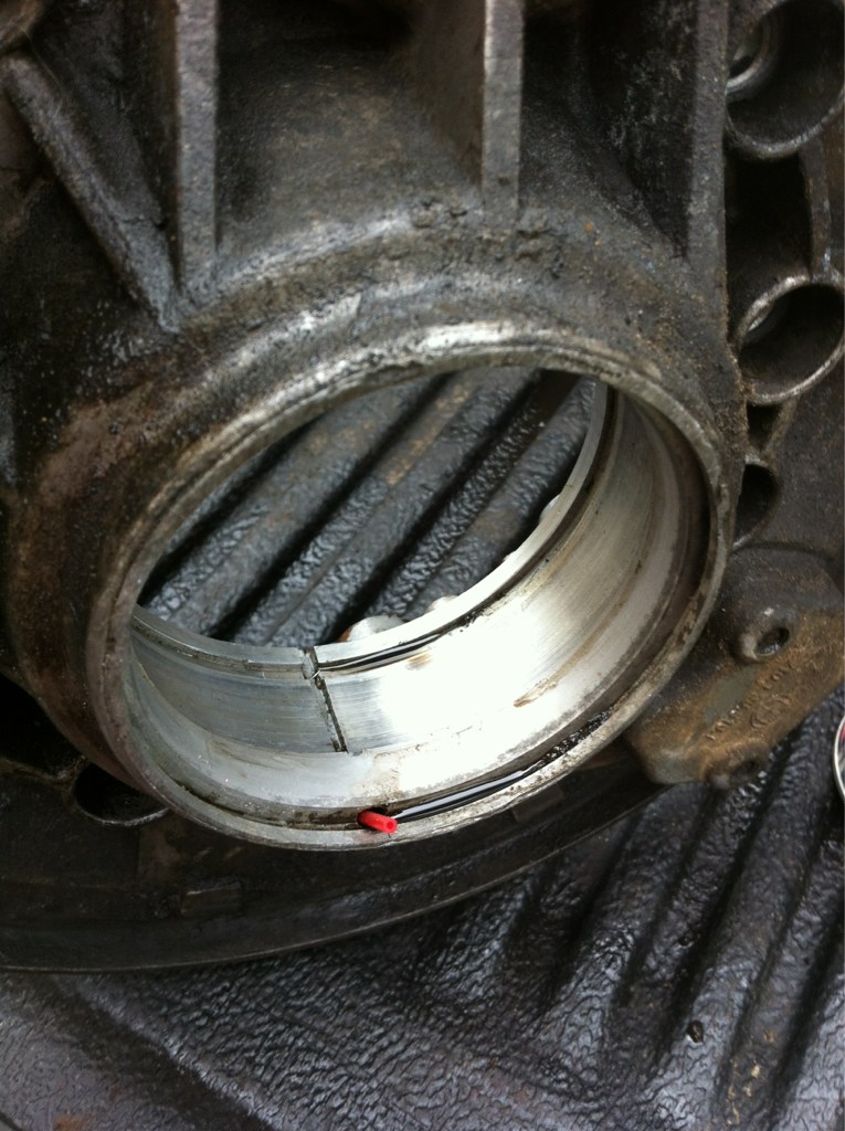

By the way, ever wonder where that weep hole on the back plate originates?

Not much more I can do today, but I decided to install the spacer/wear rings and o-rings. My PVC came in handy again.

The weep hole is there to allow gear lube that may get by the seal to get out of the brake area without contaminating the brake parts. So sayeth pcolette per Willy at SAV...

undysworld wrote: The weep hole is there to allow gear lube that may get by the seal to get out of the brake area without contaminating the brake parts. So sayeth pcolette per Willy at SAV...
Interesting, I did not know about the weep hole.
Not to detract from your bearing repair thread but does the weep hole mitigate this concern? viewtopic.php?f=13&t=7110

I don't think so. Let's say the hole is clogged, and mine was VERY gungy (I had to run that straw through multiple times to clean it), the synthetic oil will migrate somewhere.

djw wrote:Interesting, I did not know about the weep hole.
As I understand it, yes. Assuming the weep hole is NOT filled up with debris, and assuming the seal fails, then the fluid would exit through the weep hole and be evident on the rear of the wheel drive (thus prompting repair) instead of destroying the lining on the brake shoes.
