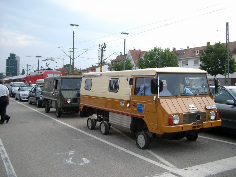

or...

edzz wrote:or...
Edzz, what is going on there? Rubber donuts on the brake drums??

Re: Sacrilege? Lowered ride height?
E_Swift wrote:
edzz wrote:or...
It is my understanding that they are waiting to drive on-board a train that has height limits. The "wheels"
are just big enough to protect the brakes.
