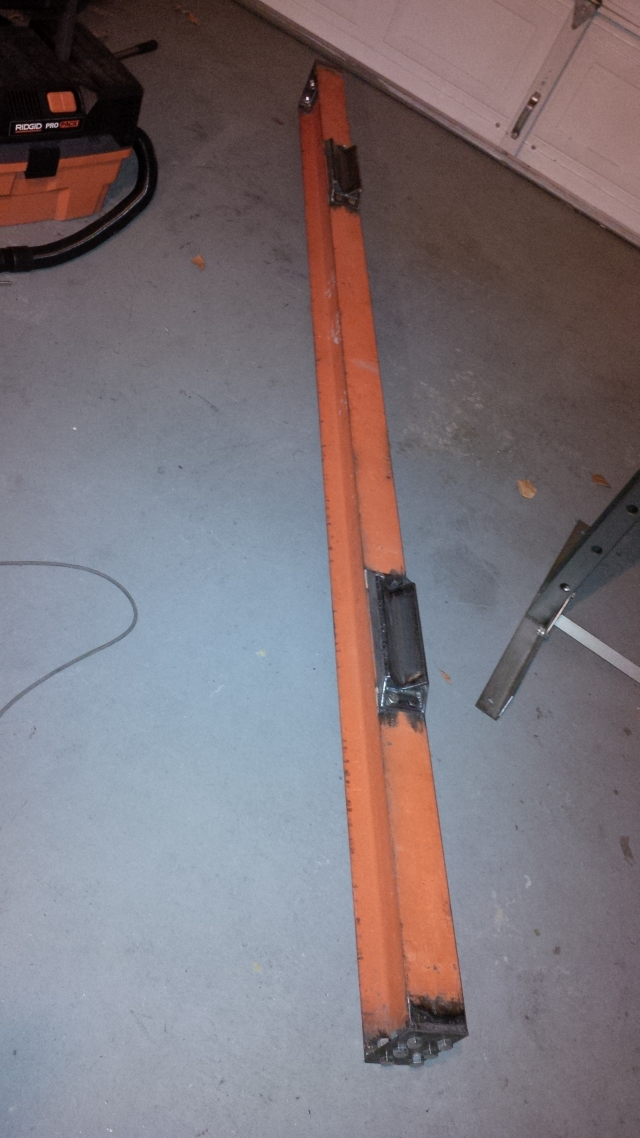

For the rear I am planning on using a 6" x 9' I beam that I bought on craigslist. I made some V blocks that I bolted to the top to keep the bumpers from slipping off.. Originally I was just going to bolt on a couple of pieces of channel steel on the ends to keep it from tipping and stack cribbing lumber under it.
But now I want more height and was thinking of making something like this with 3" square tubing:
I guess the front one would have to look more like an air lift bumper jack of some sort..
But taking the wheels off first and then lowering the drivetrain onto platforms with caster wheels is a good idea.. I will have to think about this some more...

If you've got the height and an I-Beam to span the width, why not just put some tube up under the beam to support the vertical weight, brace it all to the walls, then lift the complete body with that......I lift the bodies with a single lift point attached to a basic cradle (3 metre X 100mm square X 3mm tube)

Because I like to make things more complicated and time consuming than they need to bewhy not just put some tube up under the beam to support the vertical weight, brace it all to the walls, then lift the complete body with that
Well it is not my garage actually and so I didn't want to make any changes there but I think I might be able to get the OK to do this - it would definitely simplify everything. Have you lifted a complete 712K body with the roof and everything this way? I am wondering whether or not I would need to get a stronger tube for the extra weight.
