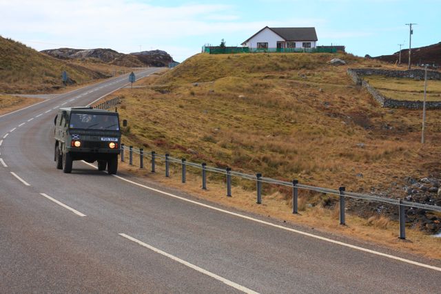

The 4x4 does feel more stable when loaded a bit. Just pack your luggage to provide the ballast and remember, as you say, it is no sports car

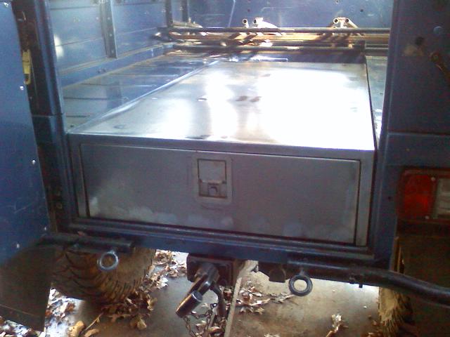

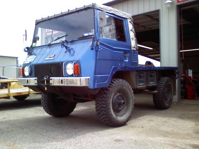

My $.02. I decided to run around "T" style while I repainted and repaired my bed panels.

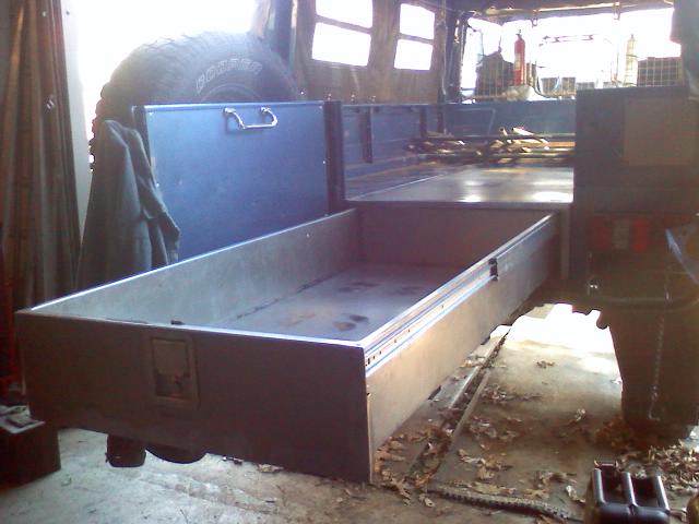

As Dave stated, a loaded truck handles the best. And if you're bent on using an M for expedition use: One of these, loaded for bear, will do the trick.
The lack of weight in the rear brought new meaning to the words "panic stop". Removing the rear roll member, canvas, and bow supports makes a minimal difference in braking or cornering. It seemed to me, the loss of the rear door and spare caused a much greater change in handling. As Dave stated, a loaded truck handles the best. And if you're bent on using an M for expedition use: One of these, loaded for bear, will do the trick.

Andre wrote:My $.02. I decided to run around "T" style while I repainted and repaired my bed panels.The lack of weight in the rear brought new meaning to the words "panic stop". Removing the rear roll member, canvas, and bow supports makes a minimal difference in braking or cornering. It seemed to me, the loss of the rear door and spare caused a much greater change in handling.
You make these alu drawers, Andre?
