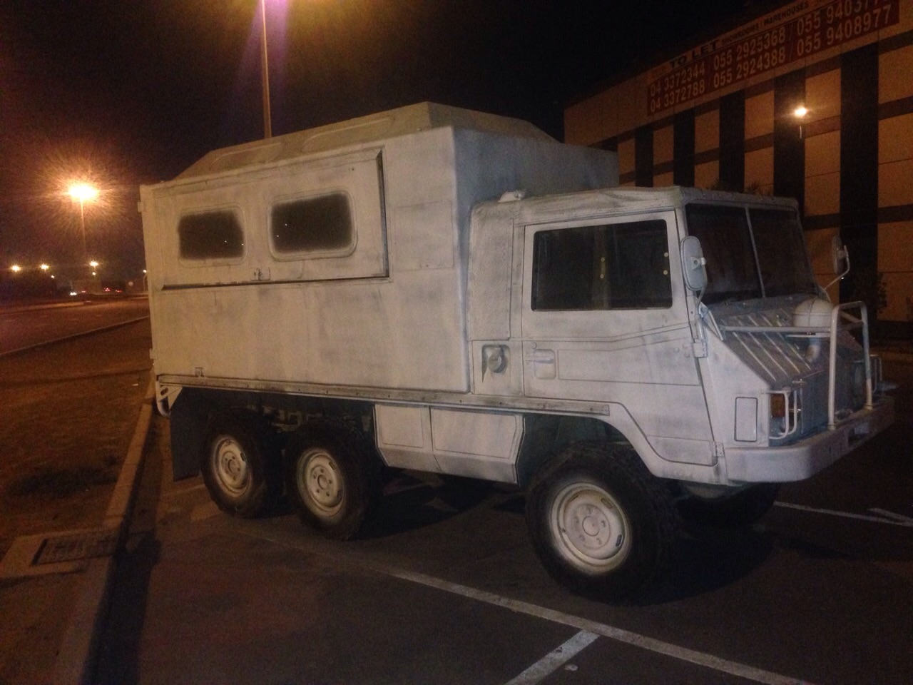

My friend's work truck has a bench on one side, sliding drawers on the other. There is a large opening window above the work bench (needs sealing).
- IMG-20150131-WA003.jpg (244.86 KiB) Viewed 4362 times
- IMG-20150131-WA013.jpg (219.88 KiB) Viewed 4362 times

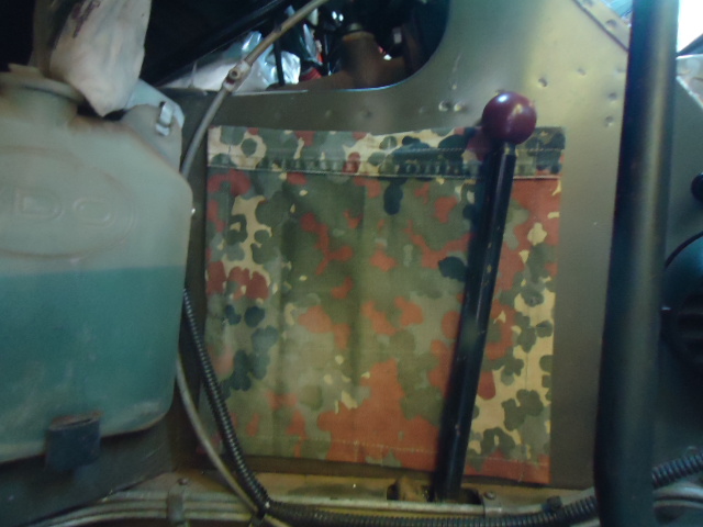

The butterfly vents are an easy solution to drawing more air into the cab...but, take note, they don't seal air tight. ...there are enough holes and air flowing through the pinz that a bit more might not be noticed. It may be noticed in the winter though. I made a cover for mine from some camo material I had and sewed in some magnets to hold it on in the winter.
I only installed a vent on the drive side.
- DSC02446.JPG (115.33 KiB) Viewed 4063 times
