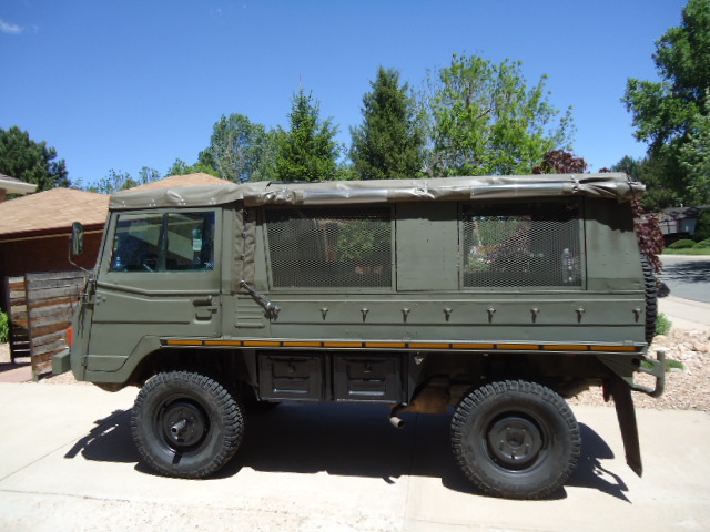

I painted my 710K in my yard, cost me about $250 with sandpaper and being I had to buy a sprayer.
Turned out real nice, just can't seam to load pictures of it now??
Look up: Fresh coat of Paint on Pinz
It will show pics of it. However it was some work do, but cost was nothing really.

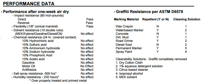

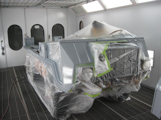

Andre and a painter are doing mine. They are scuffing the OD and then will be shooting with a commercial Martin Señor paint. Key for me was the salt spray rating, chemical resistance and abrasion rating. This paint will stand up to acid and brake fluid with no degradation.
Once body is painted it will come off and we will do underneath in the same paint but flat and then move on to undercarriage. Inside gets heat and noise reduction spray and then black bedliner (front and back).

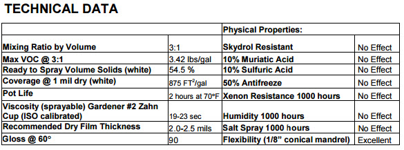

Sounds like some blood awesome body armor paint. What kind, exactly, and what clearcoat from Martin Senour have such high salt spray, chemical, and abrasion resistance ratings?

PRISM acrylic polyurethane single stage so no clear coatnicholastanguma wrote: Sounds like some blood awesome body armor paint. What kind, exactly, and what clearcoat from Martin Senour have such high salt spray, chemical, and abrasion resistance ratings?
It is part of their commercial product line Then one of there Hardeners - discussed with the paint tech in Dallas
