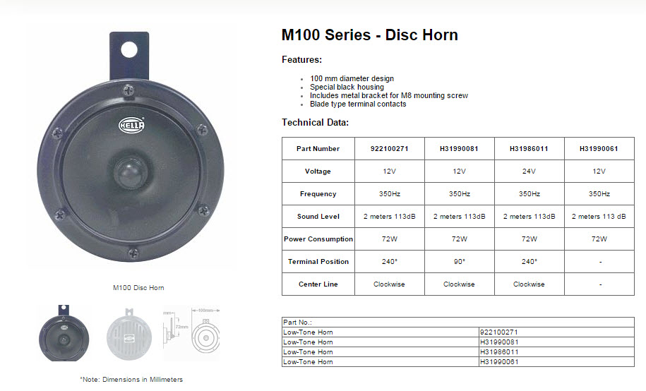

Like this?
http://mudflaps.com/i-14313350-hella-h3 ... ltone.html
or get it for only $15+ shipping here: http://www.summitracing.com/int/parts/h ... /overview/ if they actually have it!

I have this one in low-tone. It is loud enough.
http://www.rallylights.com/hl8512-super ... 09-db.html
