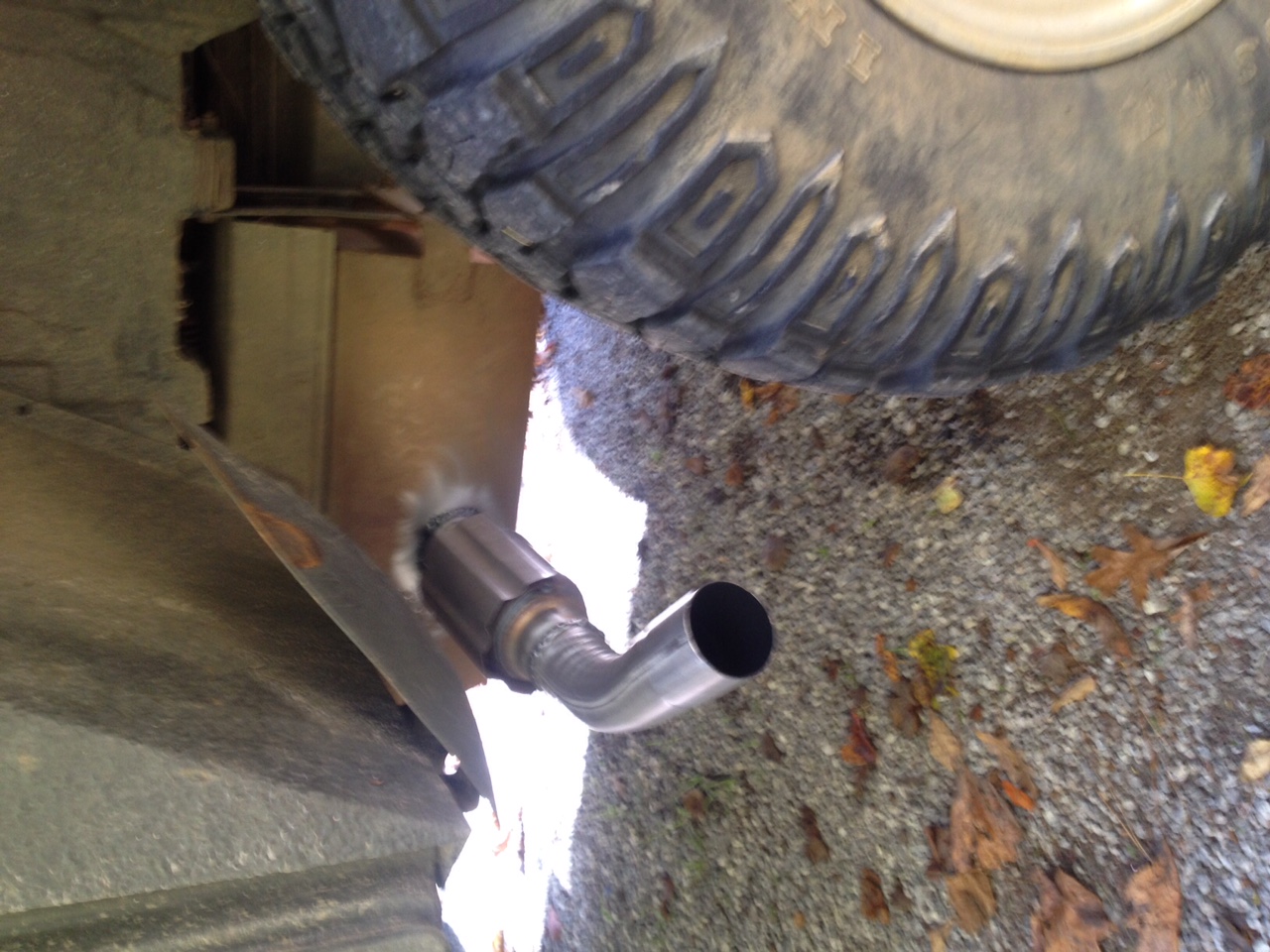

I have installed the catalytic converter and preliminary results are good. So far I have not gotten the exhaust smells or eye irritation since installing it. I do occasionally get a smell something like burnt rubber, but very faint and it is non-irritating.
I was worried about it getting hot enough but that does not seem to be a problem. Within a mile of install I stopped to check it and there was red light coming out of the tail pipe. I then began to worry about it getting too hot, but it seemed to run cooler after that. I believe it was burning off something from the manufacturing process.
I am fitting a heat shield and another hanger, but neithe seems to be a pressing issue.

Re: Catalytic converter and stench
Be careful, the cat will get substantially hotter than the muffler and if your Pinz isn't running perfect, it will amplify this affect. The cat actively burns unspent fuel, so be aware it needs good space to not scorch anything.
I don't agree with this mod, but I don't need to
looks like you did a good job, looks clean, and I'm glad you solved your problem! Just be careful!

Don't you think the shovel makes a good heat shield?
RI am pretty concerned about it over heating myself. I am driving around with a big jug of water just in case. I was going two minutes at a time between checking and am up to 10 minutes. So far excess heat has not been a problem except when I first ran it. When I first ran it there was a dull red glow coming out of the pipes but it cleared up pretty quick. I think it was something put on the catalyst when it was new. I have since cooled it all the way down and ran it again with no problems.
I got some insulation for a turbocharger and am making a heat shield. Also have a better thermometer coming to help monitor the temperature.

I have had a little more time to run with the catalytic converter. Although it does seem to help, it is not 100%.
My stench problem has always seemed to correlate with engine braking followed by WOT. A typical example is climbing a hill with hairpin turns where you engine brake going into the turn and accelerate coming out of the turn. On engine braking I have seen misfires indicated on the oxygen sensor data and small backfires in the exhaust so I know combustion is problematic in this condition. I attribute the stench to hydrocarbons produced when combustion is problematic. I think the combustion is problematic due to exhaust dilution at low intake manifold pressure.
I also have had some eye irritation, probably due to NOx, but I have a harder time saying exactly when it is a problem,
I have a test hill near my house, about 1,000 feet of gain with four hairpins. I can now get up and down the hill with only an occasional faint and brief smell. I now have no eye irritation. The stench used to be notable on ths hill.
I am still getting an occasional smell off road but I have not been getting it often enough to say when yet.
My thermometer shows that I am getting temperature rise across the catalyst going down hill but not up. I think going up there is not enough residual oxygen passing through the catalyst for it to work on hydrocarbons or CO. My mixture is a bit rich for the catalyst (12.5 to 14.5) when going up.
I am surprised by how much exhaust cooling I am getting between the headers and the tail pipe. I am losing about 150 F. The catalyst would work better if it was closer to the headers.
I am not sure what if anything I will try next. Maybe try retarding the timing a bit slowing the idle speed down and then opening up the throttle idle setting to compensate. This should decrease vacuum with the throttle closed so should help combustion. I also suspect that a bit more richness at idle may help. I have one cylinder that is running like 100 F cooler than the others but so far have not been able to figure out why. It may be lean.
Not sure when I will get around to changing out to the SSI.
