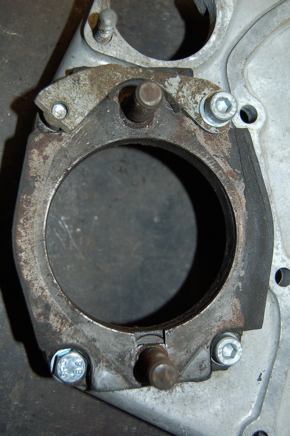

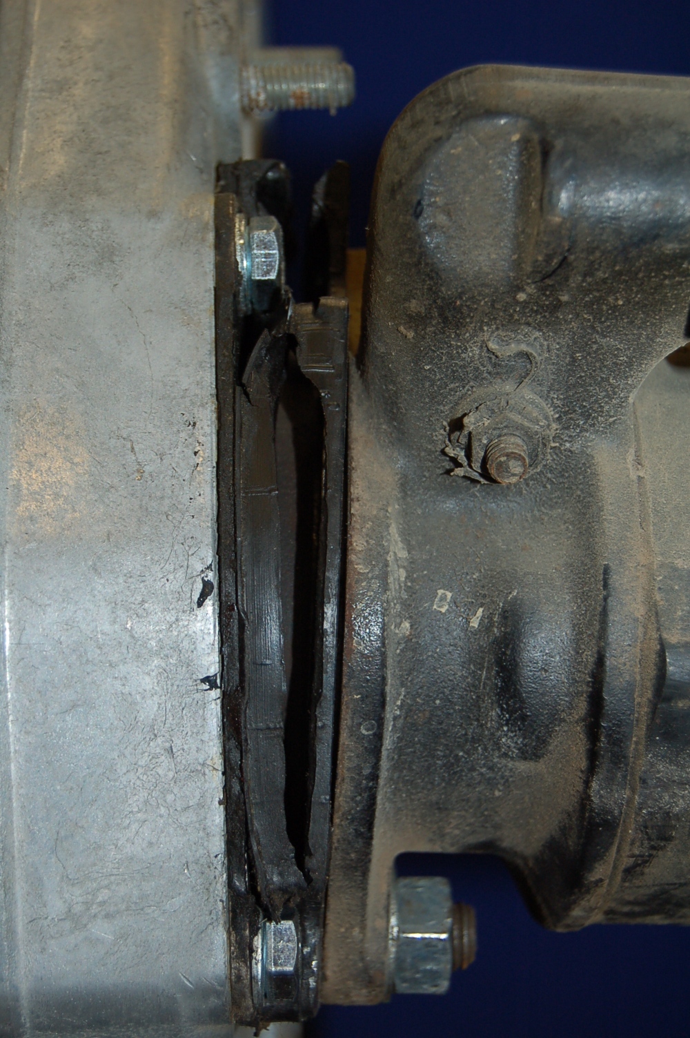

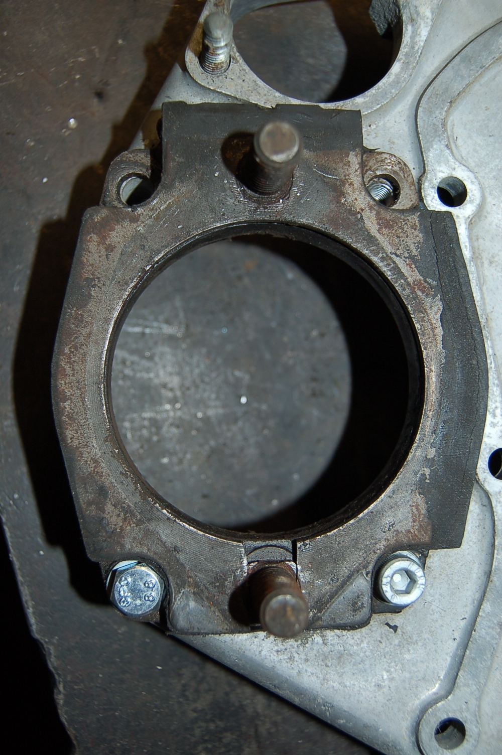

Not an uncommon problem but not as bad as it use to be. Have seen a couple trucks which looked to have been serviced and for some reason the little metal brace/keeper was not reinstalled.
Pinzgauer Starter Photos (8).JPG (703.21 KiB) Viewed 3201 times
Pinzgauer Starter Mount with out metal bracket.JPG (685.25 KiB) Viewed 3201 times
Pinzgauer Starter Mount with metal bracket.JPG (690.91 KiB) Viewed 3201 times
