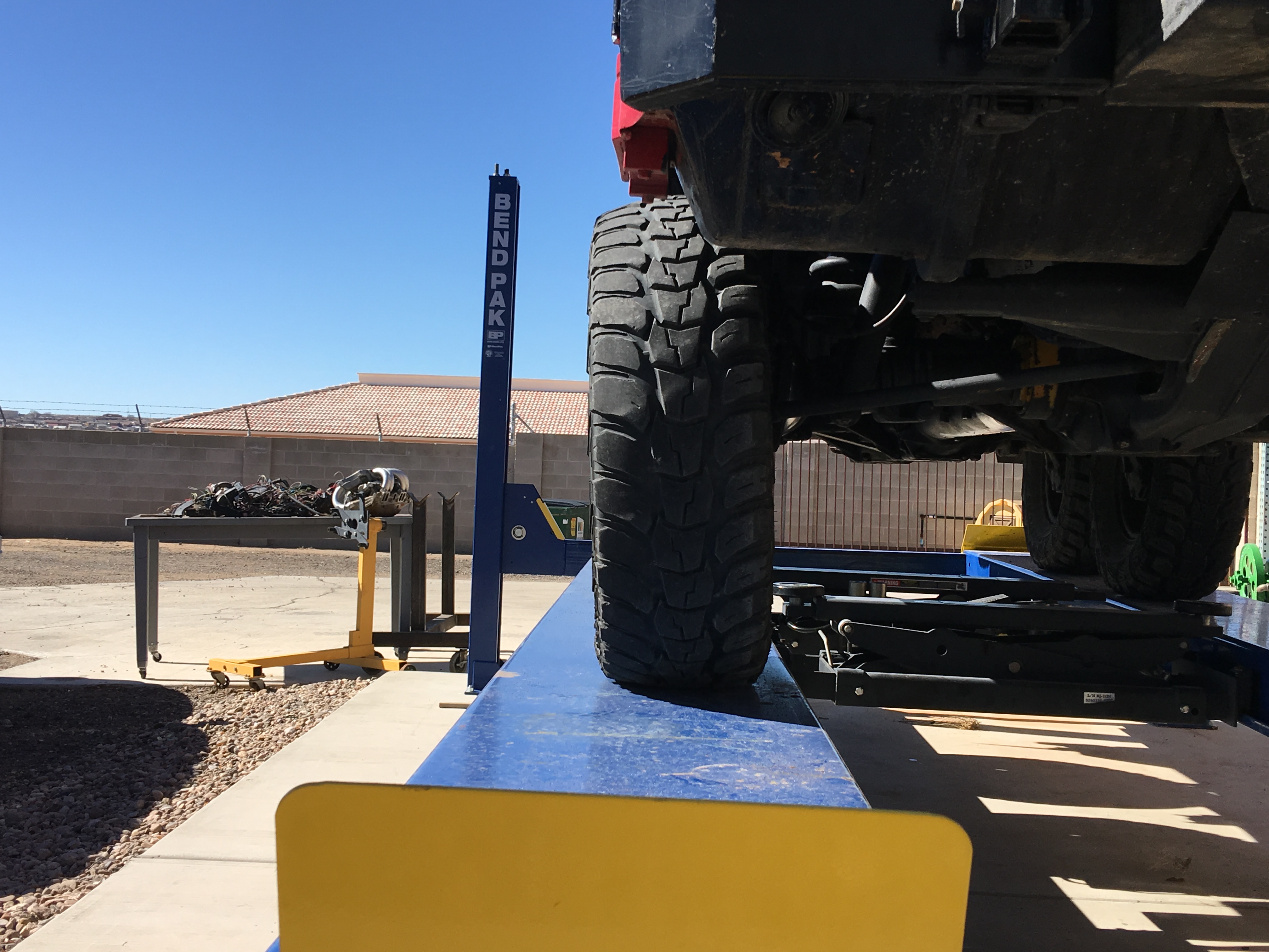

Any suggestions on locally sourced shocks? Also, with the weight know, is there any suggestions as to the correct springs I should be looking for? I definitely need to shorten the bottom pin so that the tires sit flatter. Attempting to add a photo of the stance and pin. The overload springs will be leaving soon, too.

Re: 718 SOCOM front springs
I don't have any recommendation on shocks other than try to cross reference the originals.
As for the springs, you are mentioning "overload springs", and removing them too.
This now is beginning to sound like a "shotgun" method of repair.
Post clear photos of the wheel stations to see what you have.
Before cutting pins, lets see what you have, then get the suspension back to original. You may not need to do anything else since the truck is missing all the crap the military had overloaded it with. Either replace those tires or at least reverse them on the rims for the time being. Also measure the length of the pins and compare them to the sizes in the part manual.
Unfortunately, I gave up all my manuals when I sold my 716 and the only material I have now is specific to the UK modifications made to Pinzes.
Look at the picture in a holistic manner instead of looking at one thing and guessing that is the problem and compounding things down the road.
