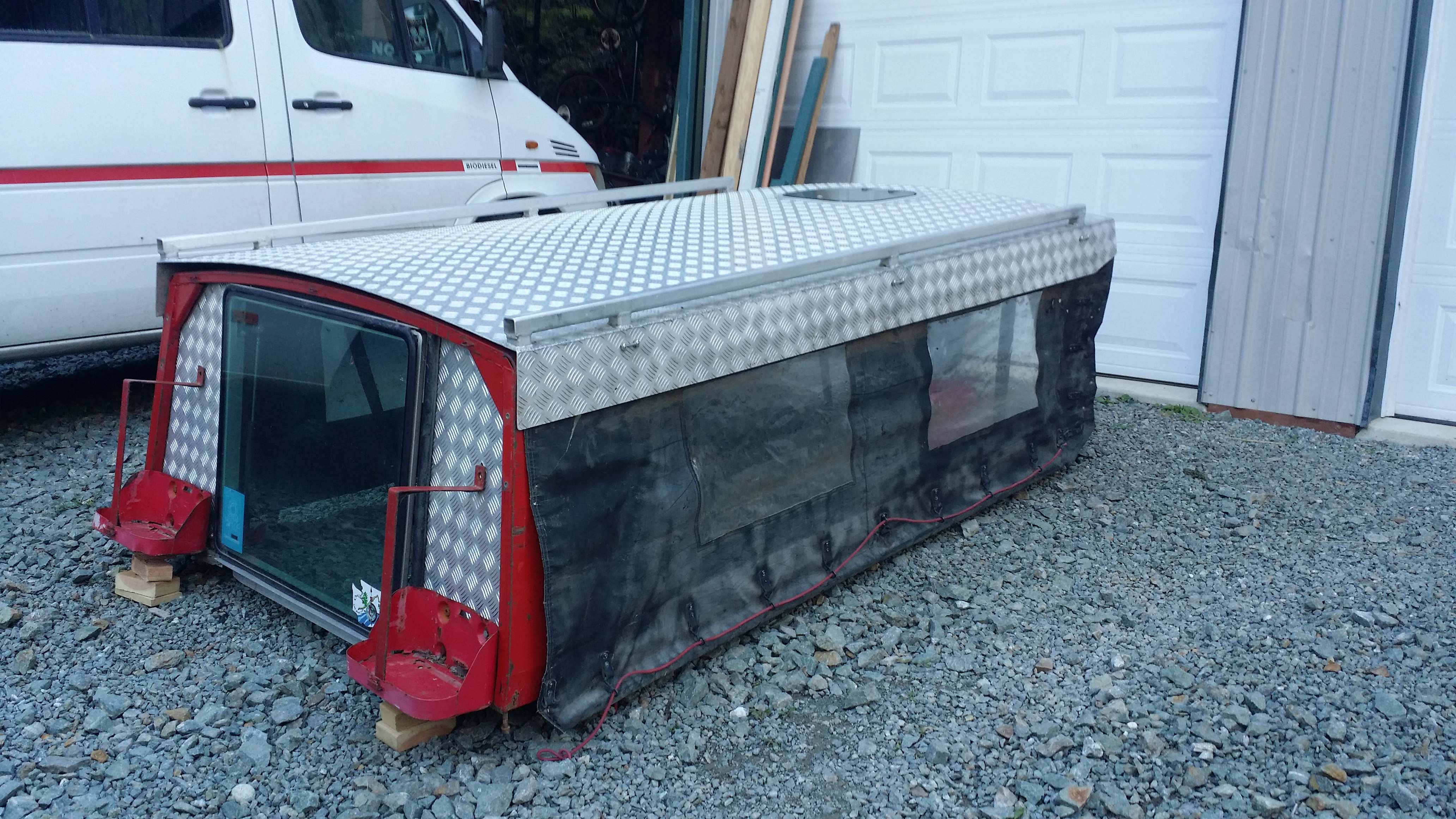

I do happen to have a nice aluminum hardtop available and can arrange delivery to CA... I am in WA.
You might want to look at how the zip line companies set up their trucks - they seem to typically use 712M's.
As far as removing the sides and not the top - it probably is possible but would require the use of a sawzall to do it... I've always seen the top and sides together as one unit when the top has been removed from a 710K or 712K.
- Aluminum 5 Bar Pinz Rear Top.jpg (987.78 KiB) Viewed 16004 times
