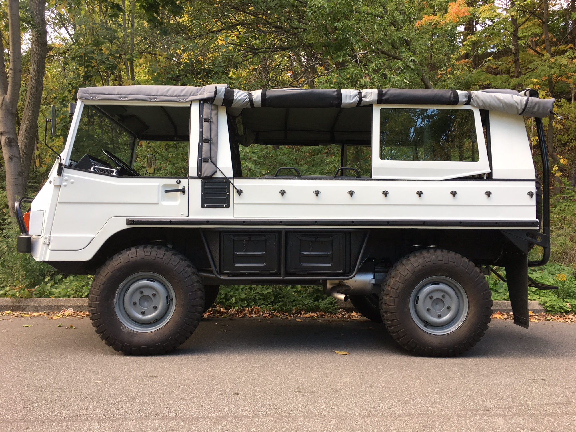

710M rebuild
Re: 710M rebuild
Headed North!!
Re: 710M rebuild
That is one fine looking pinz. Be proud.
Posts: 1551
Re: 710M rebuild
What! No winch? Are the trails that easy in Maple leaf land :lol:
Man that's one Awesome looking Pinz -- you got the Power Steering built in too right?
Re: 710M rebuild
Winch mount is in the back.
Once here I will look to source a winch.
Wondering how I can get 1 winch to work with both a 24v Pinz and a 12v G - dual motor gigglepin or I have read of people that run their 12v winch at 24v?
Posts: 1644
Re: 710M rebuild
Great looking truck! Lots of nice functional upgrades with a great paint job.
Enjoy!

Re: 710M rebuild
My truck arrived today!!!!
1st time I have actually seen my truck since I purchased it 3 years ago!!
It's been a long haul and an increadible project. The truck is nothing short of increadible.
It arrived at 2:30 this afternoon and we had a party to got to at 3 so I got to spend only about 5 mins in it :(
May need to take off work!
Will be posting lots of pictures soon
The quick drive that I did around the block and into the drive... the 2.7 EFI fired right up and the EZ power steering seems to work well (more thourogh testing to come).
Jim and Andre did amazing work on it! Jim striped the engine and worked his magic and Andre stripped the rest of the truck right down, cleaned every part it, powder coated pretty much everything we could and fabbed up a bunch of custom parts!
Just need to get it plated and we're good to go.
More to share soon
Massive grin on my face - Dan

Re: 710M rebuild
1st real test drive went well
Still need to get it "officially" plated before I do much more driving
For now I am just crawling all over and under it.
Posts: 776
Re: 710M rebuild
Post by stiffler4444 »
How in the world are you going to bring yourself to getting this dirty???? :shock:
Re: 710M rebuild
Peer pressure :)
