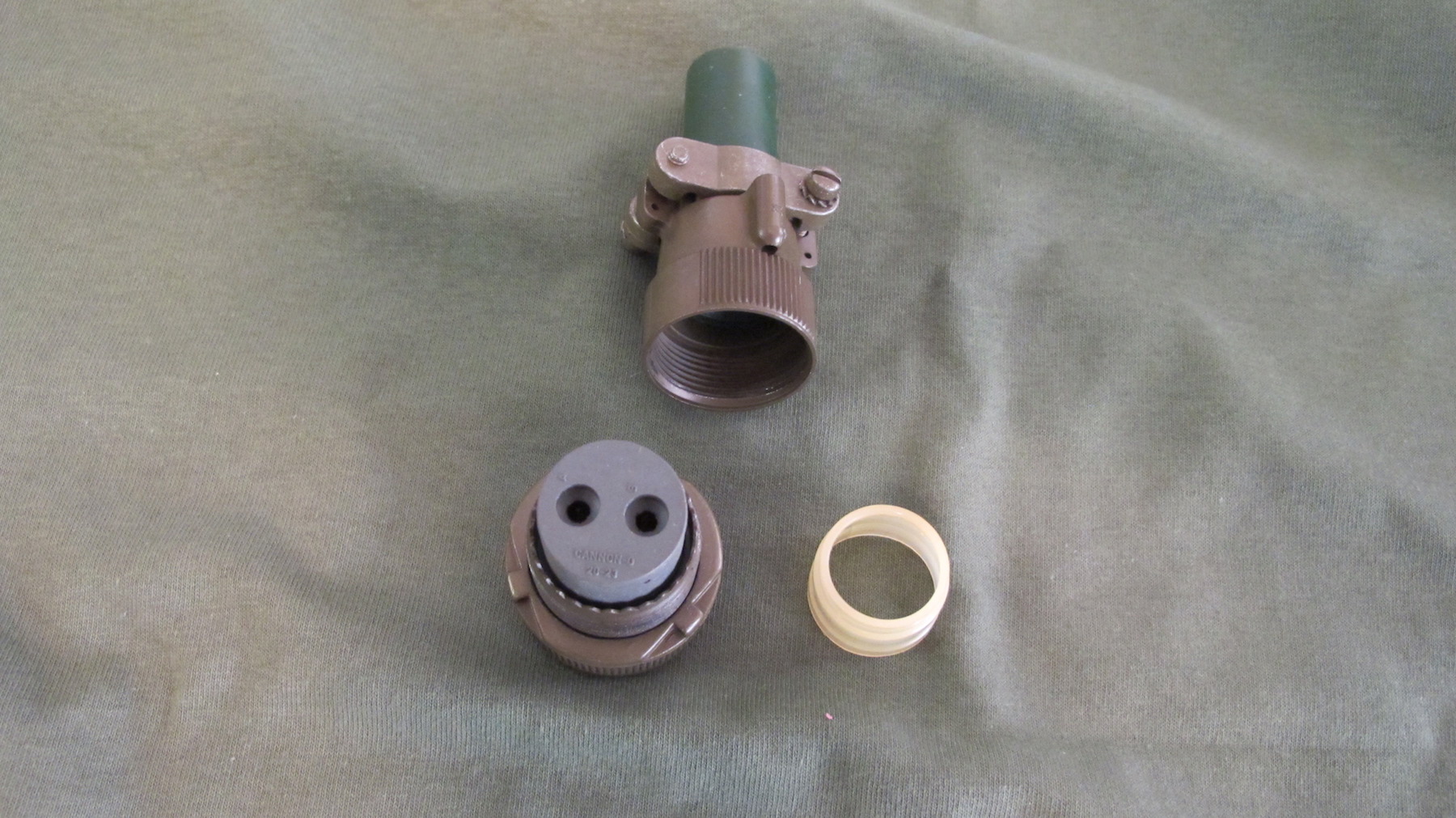

Here's a picture of the new plug end where the new wires are to be soldered into the male pins:
Here's a close-up picture of the new plug end where the new wires are to be soldered into the male pins:
Here's a picture of the new plug showing the male pins and keyed slot that will only let the plug go into the existing plug one way:
Here's a picture of the plastic sleeve over the flex where the new wiring will leave the plug:

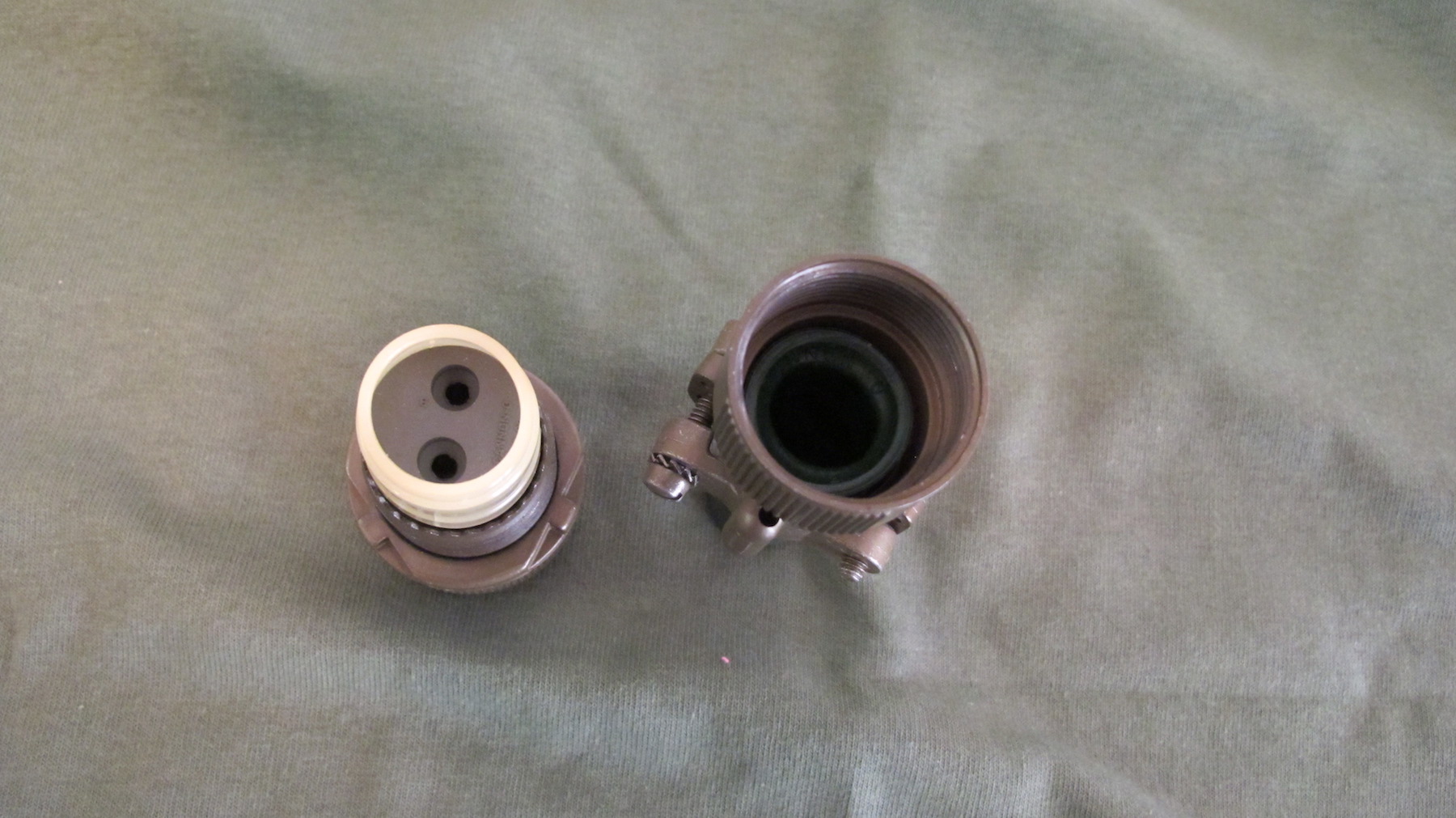

I've heard posts about soldering the new hot wire to A or B on the new radio plug. I've added pictures of mine to show more detail which should be helpful. In my case my new hot wire will be soldered to pin B which is where the hot wire to the existing plug is. In my case pin A is just a simple ground to an existing radio plug mounting screw. All is dictated by the keyed slot in the new piece requiring the new plug to be inserted into the existing one only one way.
Remove the rubber plug insert from the pins in the new plug. It goes on top of where you solder your wires into the pins.
Here are pictures of my existing radio plug clearly showing the keyed slot guide, pins A & B and that my hot wire is on pin B:
Here are pictures of my new radio plug showing the rubber plug, keyed slot and pins A & B:

To finish up the documentation, the rubber plug goes on top of where you weld the new wire to the pins with the larger holes in the rubber plug going onto the pins. The plastic sleeve then goes over the rubber plug and the top compression nuts pushes down on that sleeve. The holes in the rubber plug are tight, but fine for the 8 AWG power wire I will be using. The 8 AWG power wire fits fine into the new pins, but a little loose, so solder will be required to fill and tighten up that connection. Here are some pictures:
